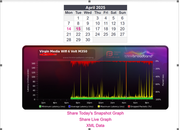

poor connections on MS teams and netflix

I started the BQM test earlier, please see results so far:

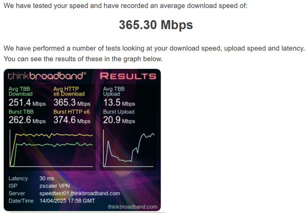

Please see speed test below:

  • ttps://www.thinkbroadband.com/broadband/monitoring/quality/share/612585055b442b92f2c04e23f91f5c232730766b-15-04-2025
      That is a horrendous BQM, with far too much packet loss.  Lets see some more evidence as below.

    The think broadband speed test is run over a zscaler VPN,
    that totally clouds the state of your internet connection.
    Best not to stream video or use MS Teams over VPN.
    Strange as your stats look fine, did you reboot the Hub just before gathering the stats?
    As foe Samknows, you need to run the FULL tests so it shows the upload, latency and jitter stats.
