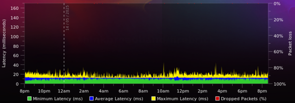

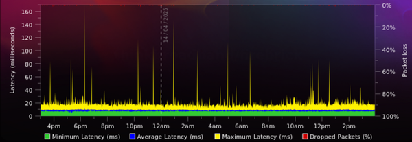

Packet loss
Hi, I'm having a constant packet loss registered on my BQM:
It's been going like that for quite some time. The router is in the modem mode and it was fine for some time before the issue appeared. Could you please look into it? Thank you!
