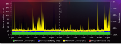

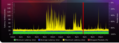

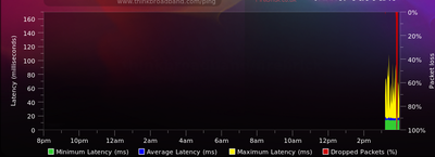

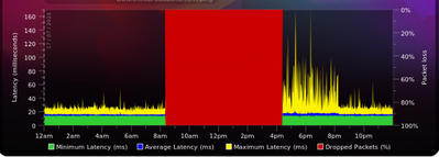

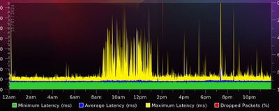

Been with virgin for around 2 years now and as the month go on the speeds provided are going slowly down and packet loss is getting worse and worse by the day, The prices skyrocket yet the product provided is poor, i live in a household where wifi / internet is essential but they do not seem to care and instead would rather " Diagnose " things and say its all well, i have tried all the tips and tricks provided by them and nothing has been helping iam getting sick and tired of it honestly and even considering switching providers. I am getting a quality monitor setup to catch this packet loss on a graph but not sure how long that will take anyways here is other things that may help.
HUB Type: 3
Speeds Paid for:  50mb/s Down 40mb/s Up
Speed provided: 35 - 40mb/s Down 20 - 30mb/s UP
Ping: 23ms average Spikes up to 2000ms randomly
Packet Loss: Jitter From 20 - 30 % every 2 -  3 seconds

  • Current thinkbroadband graph its been 40 mins and already showing huge packet loss
