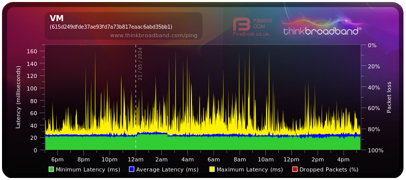

Recently, we have noticed a lot of 'lag' in games, and so created a broadband monitor to try and ascertain what's going on:-
It would appear from the monitor results that the average latency is 22-23ms with huge spikes throughout, surely this cannot be right?

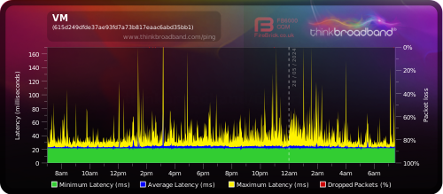

    There is a bit of packet loss from 22:00 to midnight on that BQM as well.  I would be keeping an eye on things for a while yet.
  • Apparently my Hub 3 was faulty (or just not up to the task).

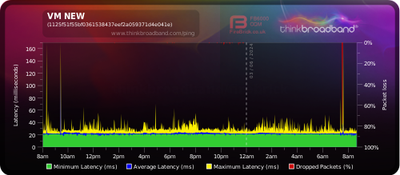

    Results from Hub 5:
    The large spike around 07:30 today was from me upgrading my package 😊

    That's interesting @Robert_P.  According to the BQM, the minimum latency looks about 25mS, and it's often much higher than that.
  • Live Graph:-
