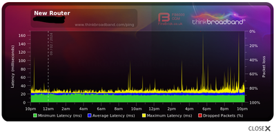

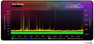

Hi, Over the last 1-2 weeks I have noticed I have started getting a lag on my hard wired connection on Xbox on the likes of Call of Duty and kids having issues on Fortnite. I have since ran a BQM for the last few days and noticed I am getting random spikes in latency which roughly matches the time we have issues while gaming and getting lag spikes.
I am not sure if its a network issue or what. I have checked the cable in my house which is only like 1m long as the entry point is right next to the router and the cable is tight. I have even changed ethernet cables just as a precaution but still no change.
Please see below my BQMs for the past few days and my router stats, hopefully its a simple fix (I have rebooted the router etc which hasn't helped. I even disconnected the VM cable and reconnected but nope.
I have also noticed in the Hub 5 log over the last day I have a few entries saying: DBC-REQ Mismatch Between Calculated Value for P1.6hi Compared to CCAP Provided Value
Hub 5 with 1gig connection.
25/01/2024
26/01/2024
27/01/2024 (Red will be when I disconnected everything and made sure all cables were secure)
28/01/2024
29/01/2024 (until 11:40am)

  • Started a new BQM monitor once I detected I was having the issues still.
  • legacy1's avatar
    legacy1
    BQM to hub shows nothing much might be as good as it gets for you so get your own router with 1Gb ports to test BQM past the hub in modem mode

      BQM for the last 24hours.
