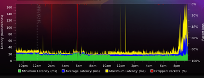

1gig, hub 5, unusable for online gaming, packet loss and latency issues
Hello,
I've been with Virgin for almost 4 years now, as they are unfortunately the only provider nearby that does high speed broadband.
I say unfortunately, because I have nothing but issues both with dropouts and online gameplay since joining Virgin. The Hub 3 and Hub 4 were both awful even in modem mode and contributed their fair share towards the issues. I've recently managed to get upgraded to the Hub 5, but aside from the dropouts being fixed, the issues with latency and packet loss continue.
Online gaming is virtually impossible now. Even when the latency is good, I get constant packet loss varying from 1%-5%. 1% is noticeable, especially on competitive games, and 5% is just a waste of time. I setup a BQM a couple of days ago along with the Hub 5, the connection seemed relatively stable for the first day outside of a single large latency spike, but the packet loss could still be seen. As the days have gone by, the packet loss has only increased in number and frequency, as has the latency issues.
My current network setup is as barebones as can be. I previously had the Hub 4 in modem mode, connected to a Nest Wifi router as it was noticeably more reliable for everything. I've since been trialing the Hub 5 as the only router, and all I have connected to it is 2x phones via wifi, 1x Fire Stick by ethernet, and 2x PCs by ethernet. In fairness to the Hub 5, it is actually capable of functioning as a decent router, and is comparable to the Nest Wifi in performance (likely helped by no longer using the god awful Intel Puma chip in the Hub 3/4).
I figured only having the Virgin router and a barebones setup would at least help with finding the issues here. The packet loss is just as bad as with the Hub 3/4, as is the latency spikes. As I said before, the only improvement so far is that I don't have dropouts as far as I can see. The Hub 4 in modem mode still required an almost daily power cycle to maintain some degree of stability.
I have shared the BQM below. I'm currently debating switching to BT's slow copper FTTC for the sake of making online gameplay usable. I play a lot of competitive shooters, and it is literally killing me. Even online coop games were unplayable with the Hub 4 due to the dropouts. My neighbour is 3 doors down connected to the same line, and he has all of the same issues.
I've tried all the usual fault reporting processes via the My Virgin area, but the whole process is as useless as it is frustrating.
I have also attached my logs from the router below as well, if that helps.
