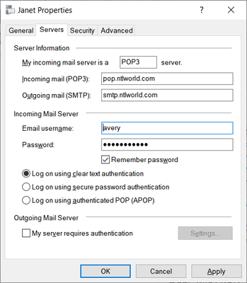

  • When I do a screenshot to show my settings the box is small and blurred . How can I improve that, so that I can show my settings as there are many things different.

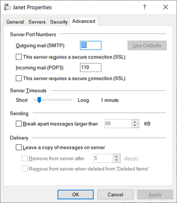

  • Thank you guys for all your patience with me. These are my settings for one of the accounts. They were working till 10 this morning. Also with no change of password.

    Assuming you have redacted the personal data bits of your email for privacy ...
    General Tab
    Reinstate your email address and surname. Leave the rest as-is
    Servers Tab
    Incoming mail: (POP3): pop3.virginmedia.com
    Outgoing mail: (SMTP): smtp.virginmedia.com
    Email username: <youremailaddress>@ntlworld.com
    Password: <Leave as-is>
    Remember password: <leave as-is> TICK
    Log on using clear text authentication: <leave as-is> CHECK
    Outgoing Mail Server: TICK My server requires authentication
    Advanced Tab
    Outgoing mail: (SMTP): 465
    This server requires a secure connection (SSL): TICK
    Incoming mail: (POP3): 995
    In the 'Delivery' section the 'Leave a copy of messages on server' bit is up to you. I you had it unchecked that can remain as-is.
    I posted the screen shots below with the correct settings (obviously leave in your personal info as-is in the relevant sections)
    https://community.virginmedia.com/t5/Email/loss-of-email-service/m-p/5545235#M278284
    if you have three accounts running in WLM you will need to repeat 3 times (the above once for each account)
  • Thanks all. GoSlow, I changed those settings and it's worked a dream. I haven't touched passwords and hope that doesn't become an issue later on. Enjoy you're summer all - thanks again
