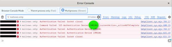

    Given the observed SMTP behaviour consider trying the following when the issue next occurs:
    • Press Ctrl + Shift + J to open Error Console window
    • Review latest log entries for a VM error code, as highlighted in example below; it may help to enter following in Filter Output field: mailnews.smtp
    What is the last VM error code reported?

      Thank you, although I did not pay enough attention to notice a code, just the error message. Thank you for your input, I will hang on to it in case it happens again and will note the code down.
      Currently (after above solution) everything seems to be working, just hoping it doesn't stop again when I get the next windows update!
