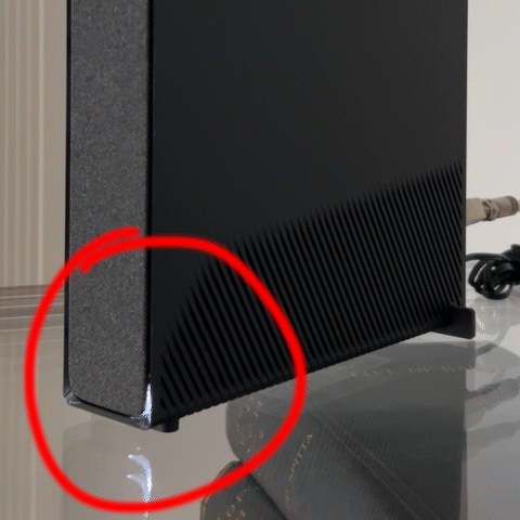

White light on Superhub goes off – what does that mean?
I've been noticing that the white light on my Superhub is occasionally turning off for around 5-10 seconds and will then come on again. I'm wondering why it's doing this and how to fix it?
I have a Superhub for the Giga service. Last week I had an internet outage which lasted around 36 hours, but this has now been fixed. Since then I've been noticing that every now and then some of my devices will have dropped off my WiFi network and I didn't know why, but I'm now guessing that this could be linked to the white light going off on my Superhub.
If anyone has any ideas on why the white light on my Superhub might be switching off I'd be grateful.
Thank you
13 Replies
  • For what it's worth I recorded a quick vid to show exactly what I mean. Every few minutes or so the white light just goes off for a few seconds and then comes back on. To me this is unusual, I've had the Superhub 5 for around 6 months now and it hasn't done this before. There was a service outage for nearly 2 days just last week and I'm wondering whether that has anything to do with it. It's not dropping the internet connection, or at least not that I notice and I'm working online nearly all day every day, but I have noticed that a few of my Wi-Fi devices are dropping off the network quite a lot which again is very unusual.

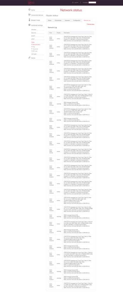

    I've taken a grab of my Network Log and I can see that there are lots of warnings going back the whole day, so my guess is that there's a problem at Virgin's end. As I mentioned above, there was an outage on my V network last week for nearly 2 days which has never happened to me with Virgin over the past 5 years, so it was quite abnormal. Virgin said the problem had been fixed, but I'm wondering whether there could still be something not right at their end.
  • This is just some of the text from the above Network Log in case it's too hard to read on the jpeg
    30-11-2023 17:57:54warningMDD message timeout;CM-MAC=**:**:**:**:**:**;CMTS-MAC=**:**:**:**:**:**;CM-QOS=1.1;CM-VER=3.1;
    30-11-2023 16:52:34noticeCM-STATUS message sent. Event Type Code: 4; Chan ID: 1 2 3 4 5 6 7; DSID: N/A; MAC Addr: N/A; OFDM/OFDMA Profile ID: N/A.;CM-MAC=**:**:**:**:**:**;CMTS-MAC=**:**:**:**:**:**;CM-QOS=1.1;CM-VER=3.1;
    30-11-2023 16:52:15warningMDD message timeout;CM-MAC=**:**:**:**:**:**;CMTS-MAC=**:**:**:**:**:**;CM-QOS=1.1;CM-VER=3.1;
    30-11-2023 15:34:13noticeCM-STATUS message sent. Event Type Code: 16; Chan ID: 33; DSID: N/A; MAC Addr: N/A; OFDM/OFDMA Profile ID: 3.;CM-MAC=**:**:**:**:**:**;CMTS-MAC=**:**:**:**:**:**;CM-QOS=1.1;CM-VER=3.1;
    30-11-2023 15:32:48noticeCM-STATUS message sent. Event Type Code: 24; Chan ID: 33; DSID: N/A; MAC Addr: N/A; OFDM/OFDMA Profile ID: 2 3.;CM-MAC=**:**:**:**:**:**;CMTS-MAC=**:**:**:**:**:**;CM-QOS=1.1;CM-VER=3.1;
    30-11-2023 15:14:09noticeCM-STATUS message sent. Event Type Code: 16; Chan ID: 33; DSID: N/A; MAC Addr: N/A; OFDM/OFDMA Profile ID: 3.;CM-MAC=**:**:**:**:**:**;CMTS-MAC=**:**:**:**:**:**;CM-QOS=1.1;CM-VER=3.1;
    30-11-2023 15:11:12noticeCM-STATUS message sent. Event Type Code: 24; Chan ID: 33; DSID: N/A; MAC Addr: N/A; OFDM/OFDMA Profile ID: 2 3.;CM-MAC=**:**:**:**:**:**;CMTS-MAC=**:**:**:**:**:**;CM-QOS=1.1;CM-VER=3.1;
    30-11-2023 15:00:07noticeCM-STATUS message sent. Event Type Code: 16; Chan ID: 33; DSID: N/A; MAC Addr: N/A; OFDM/OFDMA Profile ID: 3.;CM-MAC=**:**:**:**:**:**;CMTS-MAC=**:**:**:**:**:**;CM-QOS=1.1;CM-VER=3.1;
    30-11-2023 14:54:24noticeCM-STATUS message sent. Event Type Code: 24; Chan ID: 33; DSID: N/A; MAC Addr: N/A; OFDM/OFDMA Profile ID: 2 3.;CM-MAC=**:**:**:**:**:**;CMTS-MAC=**:**:**:**:**:**;CM-QOS=1.1;CM-VER=3.1;
    30-11-2023 14:44:19noticeCM-STATUS message sent. Event Type Code: 16; Chan ID: 33; DSID: N/A; MAC Addr: N/A; OFDM/OFDMA Profile ID: 3.;CM-MAC=**:**:**:**:**:**;CMTS-MAC=**:**:**:**:**:**;CM-QOS=1.1;CM-VER=3.1;
    30-11-2023 14:28:30noticeCM-STATUS message sent. Event Type Code: 24; Chan ID: 33; DSID: N/A; MAC Addr: N/A; OFDM/OFDMA Profile ID: 2 3.;CM-MAC=**:**:**:**:**:**;CMTS-MAC=**:**:**:**:**:**;CM-QOS=1.1;CM-VER=3.1;
    30-11-2023 14:25:55noticeCM-STATUS message sent. Event Type Code: 16; Chan ID: 33; DSID: N/A; MAC Addr: N/A; OFDM/OFDMA Profile ID: 3.;CM-MAC=**:**:**:**:**:**;CMTS-MAC=**:**:**:**:**:**;CM-QOS=1.1;CM-VER=3.1;
    30-11-2023 12:03:29noticeCM-STATUS message sent. Event Type Code: 4; Chan ID: 1 2 3 4 5 6 7; DSID: N/A; MAC Addr: N/A; OFDM/OFDMA Profile ID: N/A.;CM-MAC=**:**:**:**:**:**;CMTS-MAC=**:**:**:**:**:**;CM-QOS=1.1;CM-VER=3.1;
    30-11-2023 12:03:01noticeCM-STATUS message sent. Event Type Code: 4; Chan ID: 1 2 3 4 7; DSID: N/A; MAC Addr: N/A; OFDM/OFDMA Profile ID: N/A.;CM-MAC=**:**:**:**:**:**;CMTS-MAC=**:**:**:**:**:**;CM-QOS=1.1;CM-VER=3.1;
    30-11-2023 12:02:59warningMDD message timeout;CM-MAC=**:**:**:**:**:**;CMTS-MAC=**:**:**:**:**:**;CM-QOS=1.1;CM-VER=3.1;
    30-11-2023 12:02:55noticeCM-STATUS message sent. Event Type Code: 1; Chan ID: 5 6; DSID: N/A; MAC Addr: N/A; OFDM/OFDMA Profile ID: N/A.;CM-MAC=**:**:**:**:**:**;CMTS-MAC=**:**:**:**:**:**;CM-QOS=1.1;CM-VER=3.1;
    30-11-2023 12:02:53warningMDD message timeout;CM-MAC=**:**:**:**:**:**;CMTS-MAC=**:**:**:**:**:**;CM-QOS=1.1;CM-VER=3.1;
    30-11-2023 12:02:50noticeCM-STATUS message sent. Event Type Code: 4; Chan ID: 3 4 5 6 7; DSID: N/A; MAC Addr: N/A; OFDM/OFDMA Profile ID: N/A.;CM-MAC=**:**:**:**:**:**;CMTS-MAC=**:**:**:**:**:**;CM-QOS=1.1;CM-VER=3.1;
    30-11-2023 12:02:33warningMDD message timeout;CM-MAC=**:**:**:**:**:**;CMTS-MAC=**:**:**:**:**:**;CM-QOS=1.1;CM-VER=3.1;
    30-11-2023 12:02:22noticeCM-STATUS message sent. Event Type Code: 1; Chan ID: 1 2 3; DSID: N/A; MAC Addr: N/A; OFDM/OFDMA Profile ID: N/A.;CM-MAC=**:**:**:**:**:**;CMTS-MAC=**:**:**:**:**:**;CM-QOS=1.1;CM-VER=3.1;
    30-11-2023 12:02:19noticeCM-STATUS message sent. Event Type Code: 4; Chan ID: 2 3 4 6 7; DSID: N/A; MAC Addr: N/A; OFDM/OFDMA Profile ID: N/A.;CM-MAC=**:**:**:**:**:**;CMTS-MAC=**:**:**:**:**:**;CM-QOS=1.1;CM-VER=3.1;
    30-11-2023 12:02:19warningMDD message timeout;CM-MAC=**:**:**:**:**:**;CMTS-MAC=**:**:**:**:**:**;CM-QOS=1.1;CM-VER=3.1;
    30-11-2023 12:02:13warningMDD message timeout;CM-MAC=**:**:**:**:**:**;CMTS-MAC=**:**:**:**:**:**;CM-QOS=1.1;CM-VER=3.1;
    30-11-2023 12:02:12noticeCM-STATUS message sent. Event Type Code: 1; Chan ID: 1 2; DSID: N/A; MAC Addr: N/A; OFDM/OFDMA Profile ID: N/A.;CM-MAC=**:**:**:**:**:**;CMTS-MAC=**:**:**:**:**:**;CM-QOS=1.1;CM-VER=3.1;
  • The test just says they can’t see any issues affecting my area. Looking at my Network Log again I can see that there have been 'warning MDD message timeout' messages and notices all throughout night. I guess I really need someone from Virgin to look into this.
    • jbrennand's avatar
      jbrennand
      Double check.  Try the “free & automated” Service Status number - 0800 561 0061 - which usually gives the most up to date info. and tells you of more local issues and fix estimates, down to street cab/ postcode level.
  • Hey jbrennand, yes I've called that number and it tells me the same thing as the online service status, which is that there are no faults in my area. The thing is the service does actually seem to be OK, so maybe I should just stop worrying about it. It's just that I'm seeing the white light on my Hub go off and on all the time and in my Network Logs I'm seeing a very unusual and continuous amount of warnings and notices.
    This is an example of the warnings;
    warning MDD message timeout;CM-MAC=**:**:**:**:**:**;CMTS-MAC=**:**:**:**:**:**;CM-QOS=1.1;CM-VER=3.1;
    And this is an example of the notices;
    01-12-2023 12:20:57 notice CM-STATUS message sent. Event Type Code: 16; Chan ID: 33; DSID: N/A; MAC Addr: N/A; OFDM/OFDMA Profile ID: 3.;CM-MAC=**:**:**:**:**:**;CMTS-MAC=**:**:**:**:**:**;CM-QOS=1.1;CM-VER=3.1;
    01-12-2023 12:20:46 notice CM-STATUS message sent. Event Type Code: 24; Chan ID: 33; DSID: N/A; MAC Addr: N/A; OFDM/OFDMA Profile ID: 2 3.;CM-MAC=**:**:**:**:**:**;CMTS-MAC=**:**:**:**:**:**;CM-QOS=1.1;CM-VER=3.1;
    And these notices and warnings are just going on for the whole day each and every day, so clearly there's an issue somewhere with something.

        Hey benek, thank you for reaching out and I am sorry to hear this.
        I have taken a look at our side and I can confirm there isn't any current outage and everything is look great from our side your levels are wonderful.
        With the light sometimes they can fade but its still working I wouldn't worry about that.
        Please can you post your BQM here once I see that we can look at running some other tests. Cheers
