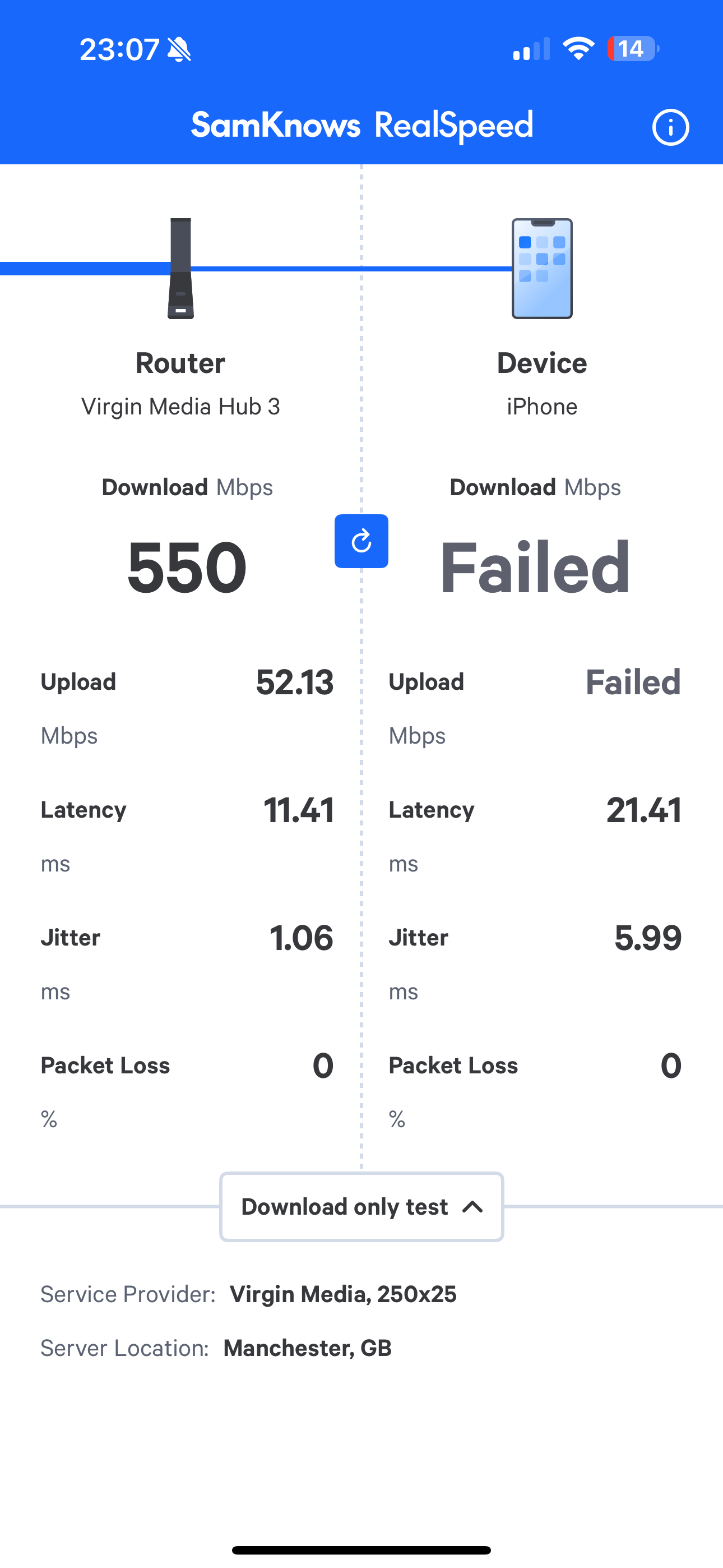

    With the Hub 3 in Router mode.   Install the Samknows Realspeed app on your Android or iPhone mobile and review the speeds to the Hub and then to your mobile.
    Run the "Full Test", the downstream / upstream speeds at the VM Hub should reflect the M500 subscription,
    if this falls well short of the expectations check the connection is being shown as 500x50 by the Realspeed app and that in the VM Hub 3 Configuration tab the speed profile is that of M500.
    The Wi-Fi to the mobile will be more variable, but should be decent when close enough for use of the 5GHz band.
  • The RealSpeed app and website are showing the package as 250x50, the download/ upload to the hub itself is showing the expected M500 package but with my phone right next to the hub both upload and downloads are failing

        It’s been the same constantly, the internet will be there for a few hours in the day working ok and then while it’s still there it’s so unbearably slow that I’d have to switch to hotspotting or using data on my phone to load websites etc up. Tried to switch back to modem mode but same issue so it’s back in router mode now to show it’s happening there too
