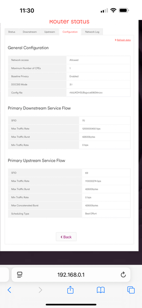

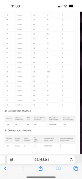

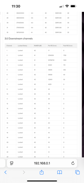

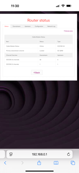

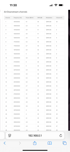

Speed fluctuation - signal and power levels check
Morning all,
I’m hoping someone can check my signal and power levels please.  Every now and again I get drop in service and my speeds fluctuate massively. Not sure if my levels are out of range or I need moving up the board in the cabinet.
Thanks
[Mod - title edited for clarity]

      Hello SteGreen
      Sorry to hear of the connection issues experienced, we appreciate you raising this via the forums.
      From checking the connection and equipment the levels look to be within the spec's we'd expect to see. How often do you experience the issues with the speeds? Does it impact all devices either wired or wireless?
      Do other's in the area experience the same issues at the same time indicating a area problem as opposed to localised to yourself?
  • jpeg1's avatar
    jpeg1
    There's nothing there to indicate a serious problem.
    The best way to check intermittent problems is to set up a free BQM and post a live link here.
