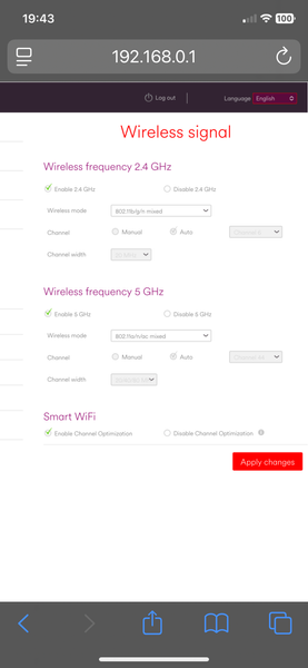

  • If you haven't got 5G and 2.4G bands then you could try splitting your Wi-Fi network, instructions on how to do that are in link below, when you have selected Advanced Settings you will also need to select Wireless, Wireless Signal and click on Disable Channel Optimization at the bottom then click on Apply Changes. 2.4G will have a stronger signal and might work better with some of your devices.
    Edited to say link removed because the instructions have been removed.
    If you are using  Virgin wi-fi pods don't split your network.
    You haven't got a smart meter yet, no worries when you do get one it doesn't connect to your home wi-fi.
    These instructions should work for splitting your network;
    Open a web browser and go to http://192.168.0.1.
    Log in using the administrator password found on the sticker on the bottom of your Virgin Media Hub, or one you have previously set.
    Navigate to the "Advanced" or "Wireless" settings.
    Find and disable "Smart Wi-Fi" or "channel optimization" to allow for separate networks.
    Save the settings.
    Go to "Advanced" > "Wireless" > "Security".
    You should now see separate fields for the 2.4GHz and 5GHz networks.
    Change the network name (SSID) for one or both of the networks to make them distinct (e.g., add "-5G" to the 5GHz network).
    You can use the same password for both networks or create a different one for each.
    Click "Apply" or "Save" to confirm your changes.
    Your Hub may restart automatically, and the two new networks will appear in your list of available Wi-Fi networks.

      Q1 how do I know if I have 5g or only 2.4 Q2 when you say splitting and name changing, would that effect my power line adaptors and the one extender upstairs
      Q3 sorry for being really stupid but if I split them what is that doing. Would the devices when trying to connect know which one to connect to

        Will lomond82 not have to split his wi-fi by turning off channel optimization first and then renaming the 2 bands differently, from his screenshot on his other post channel optimization is set to on.
        From a Google search the Hive does only use 2.4 Ghz, the ring doorbell may use both the 2.4 and 5Ghz depending on how new it is I suppose.

    thank you so much for all your assistance. Boys all got to watch football  before I started anything. So that was a plus point of today.
    Negative was : set up the TP extender and then it all went to pot, totally lost all connective to HIVE, an hr onto them and they blamed the extender but let’s face facts it will be myself that’s done something wrong. Took an hour and a half to get HIVE back, by this point extender was completed removed. Mesh hasn’t made it out the box. I am too uneducated in this as above thread shows so I am sending the extender/booster and mesh back.
    going to learn to live with drop out in communications, but thank you for not having me listening to VM and wasting money on M500 for that, and everything you guys have done last couple of days has been great. This is just time for this stupid woman to butt out , leave well alone and tell the boys to just deal with drop outs and start figuring out how I set timers and work heating direct on the electronic panel of new boiler.
