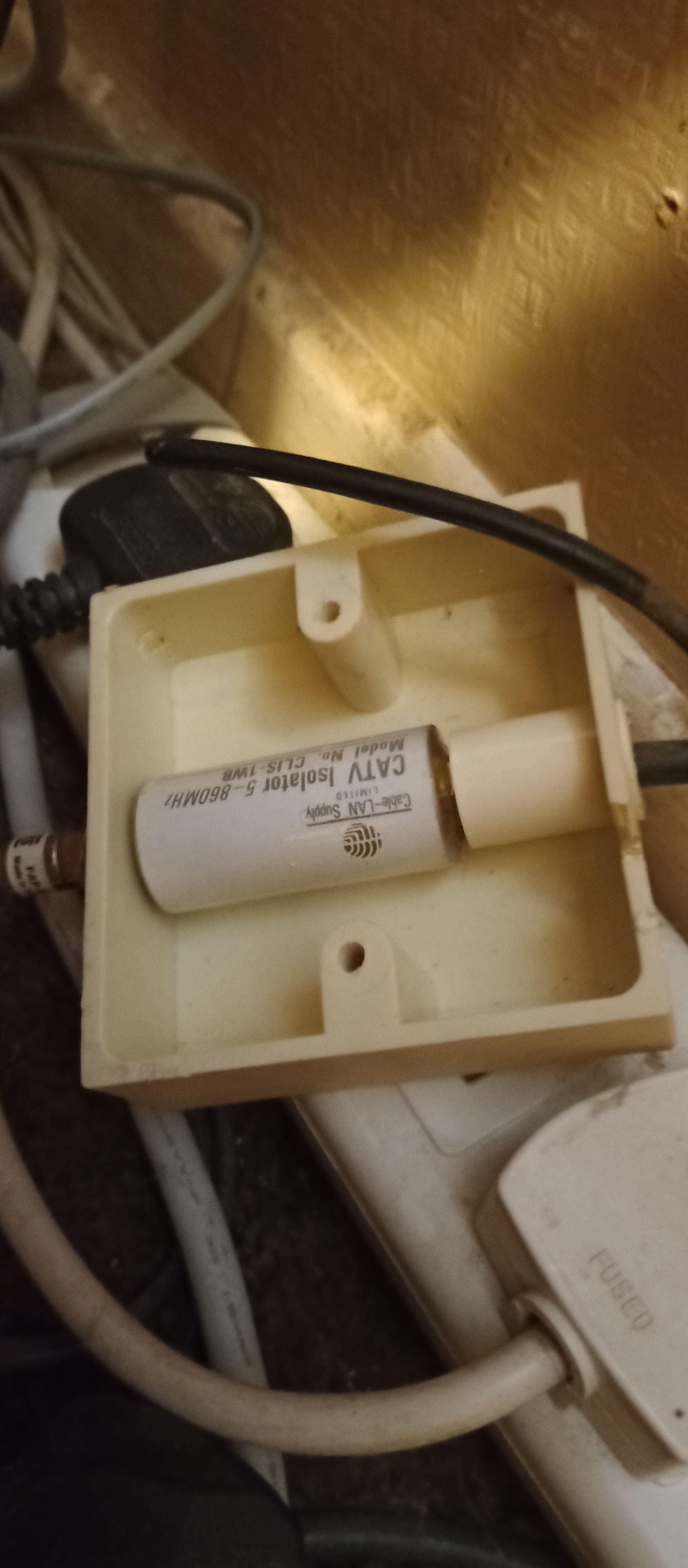

Never had it before and the socket on the wall isn't a virgin one. May have been fitted by NTL or someone like that years ago. It's marked cable in on one side and TV on the other.

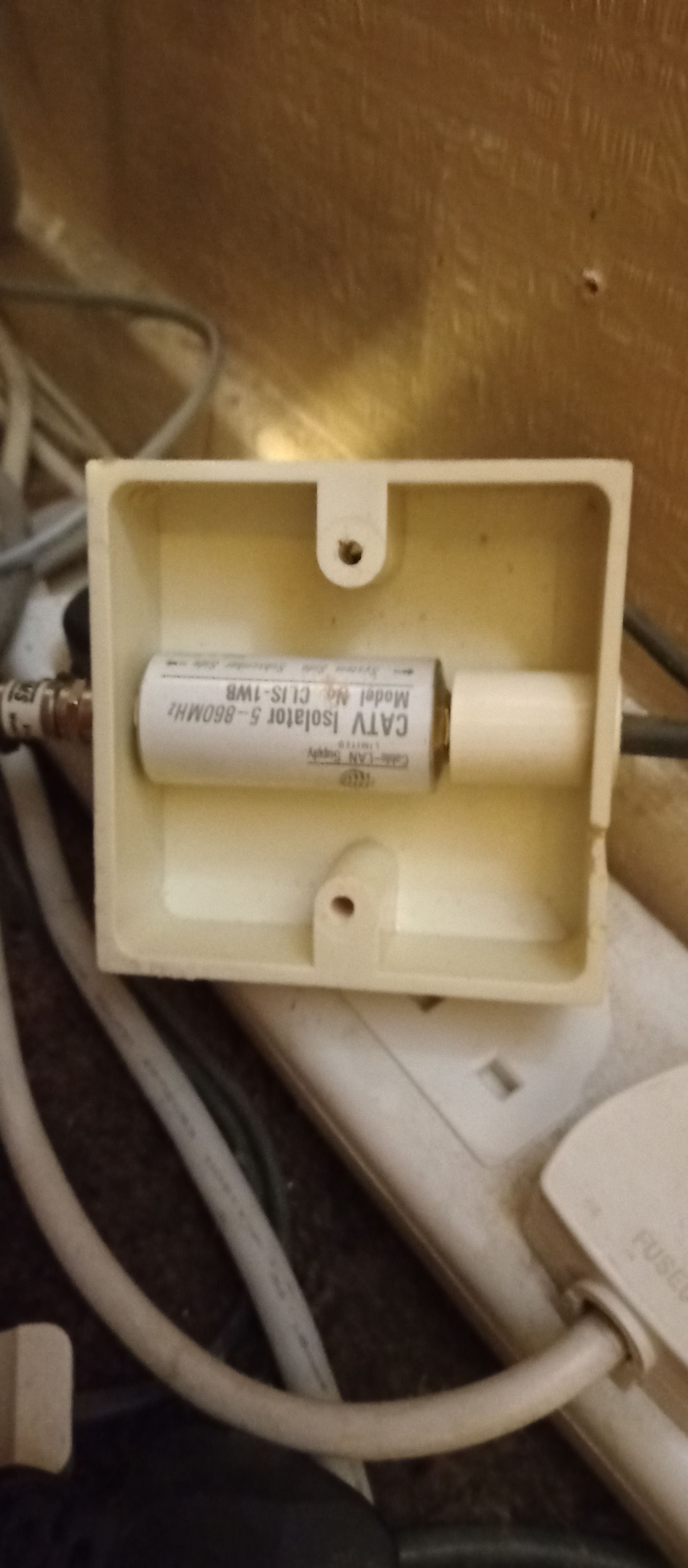

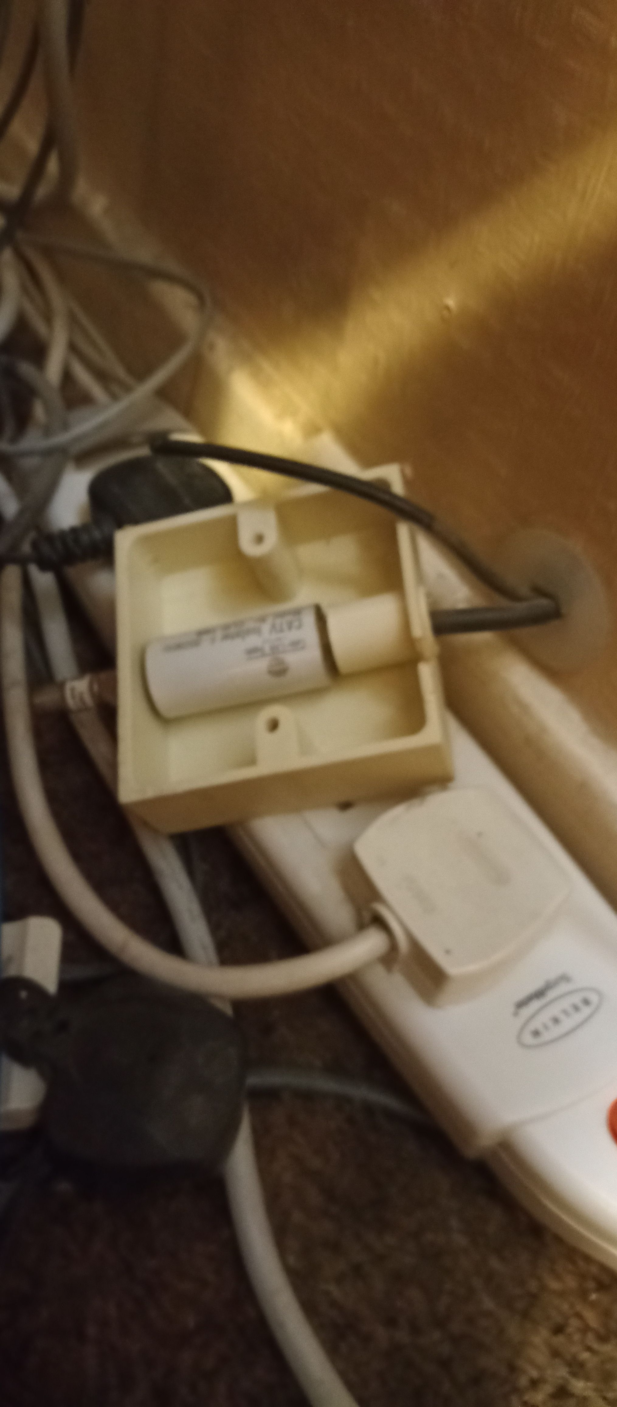

I've just taken it off the wall and there's an isolator inside but there's also another loose cable coming through the wall, wondering if that one is for the broadband, any ideas guys.
I'll try and post some pictures.
Oops, sorry about all the dust but it is all behind the TV!😁

    The one in the (old) isolator is likely to be the cable. Perhaps you are not connected at the cabinet or a cable break to the cabinet. I'm assuming the connector is tightly connected as the self-serve install kit are push on connectors not normal F-connector screw type.
    VM forum staff will be along, a technician will probably be booked, which is wise given the age of the terminal box and isolator. Technician can check power levels etc are within range too.

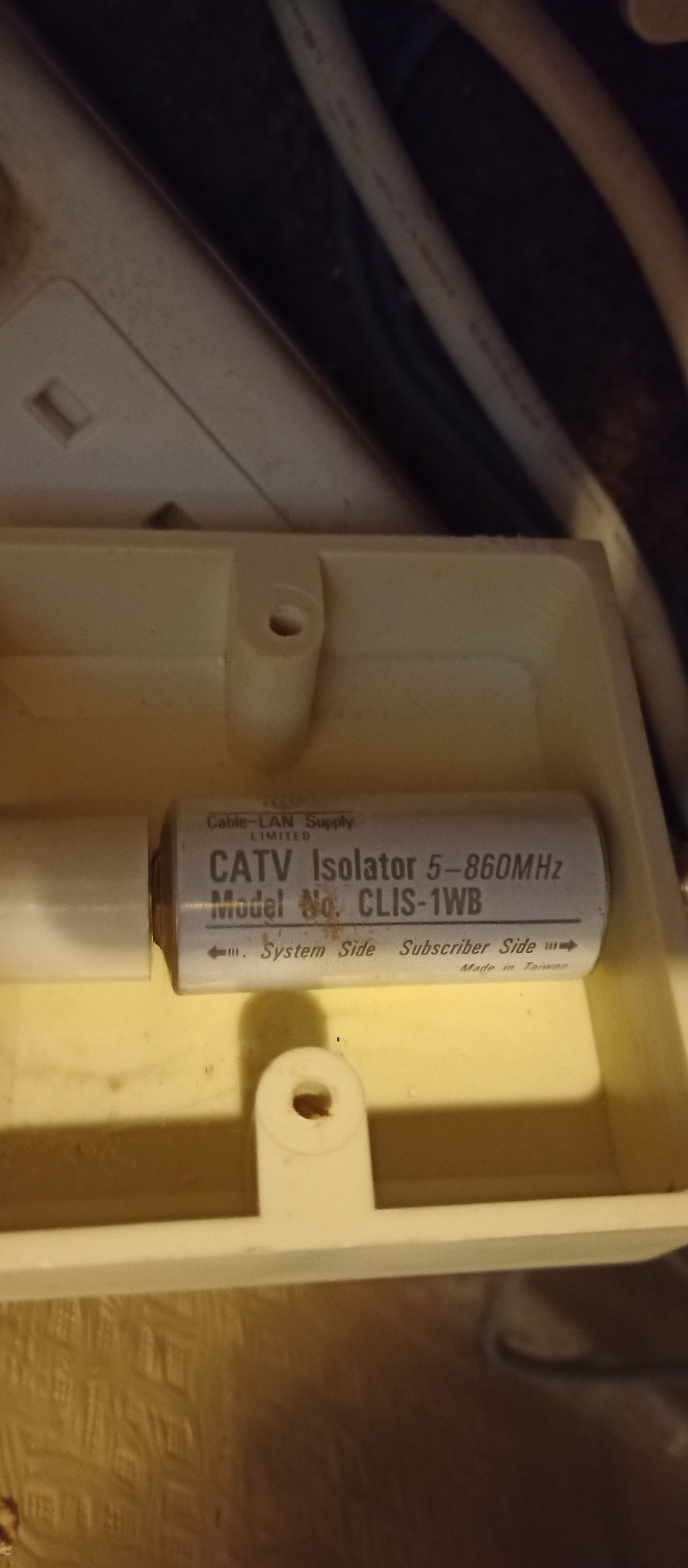

        And finally a close up of the isolator.👍

    VM send out kits if there was a previous customer at the address. They have no idea what is actually installed, or even if a previous occupant has removed the sockets or wiring needed to receive the service. A flashing green base light is symptomatic of either no signal or insufficient signal down the cable. The isolator is REALLY old & should be replaced as well as the rest of the wiring being checked.
    Call the pre-install team & they should be able to fix this, on 0800 052 1734

    Call the pre-installation and delivery team on 0800 052 1734 explain the problem and request a tech visit to install a socket.
