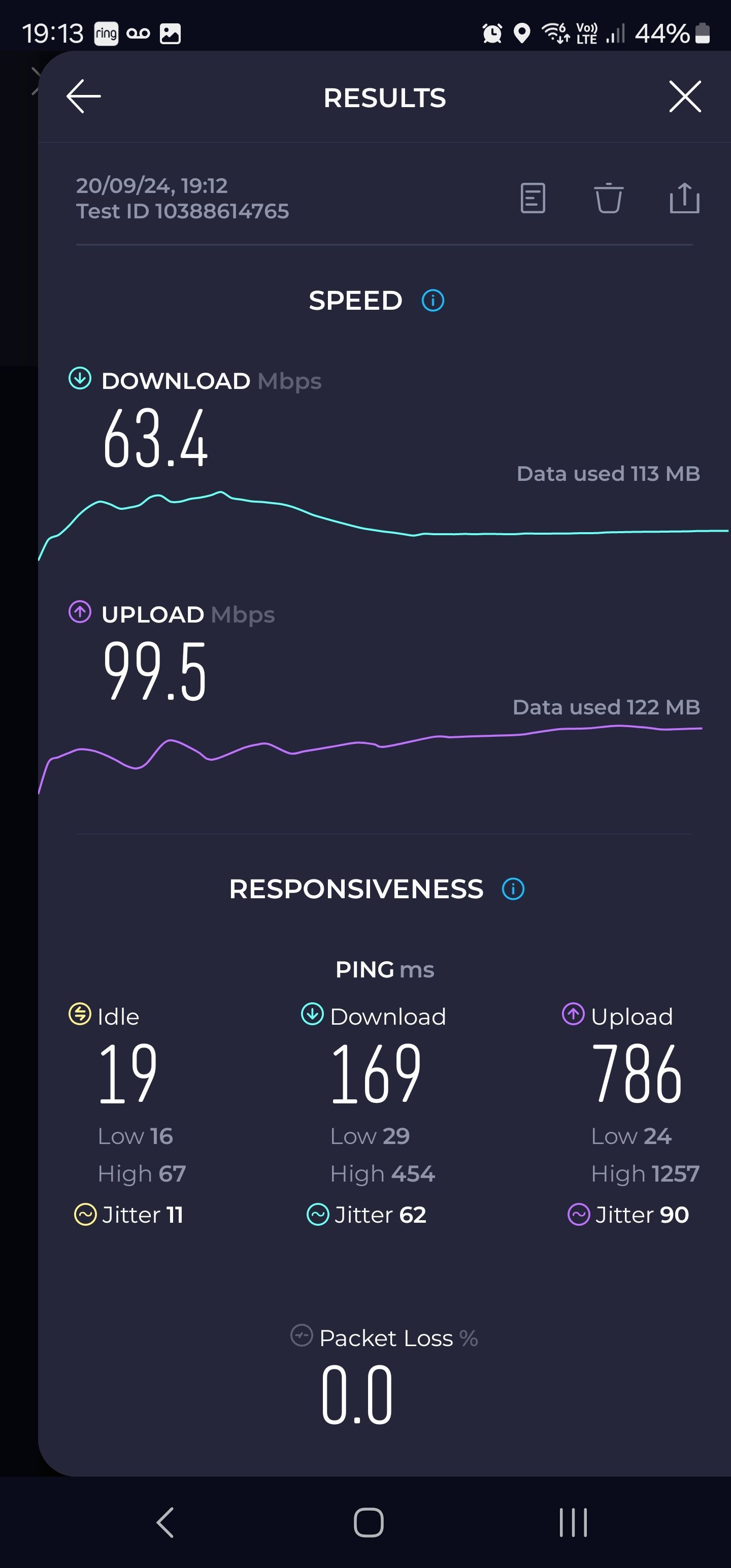

We have had Gig1 since April with no issues, but recently we are getting slow download speeds.

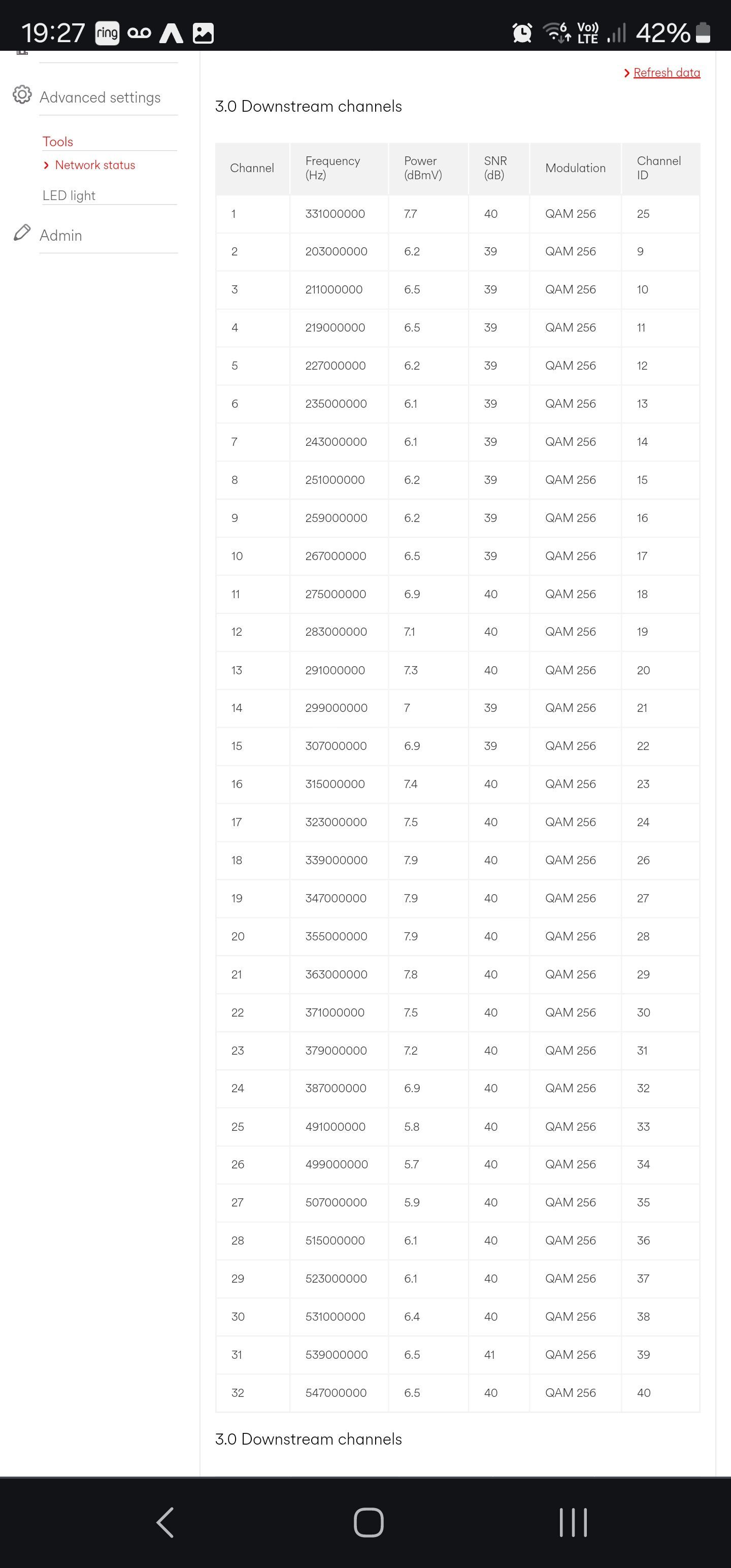

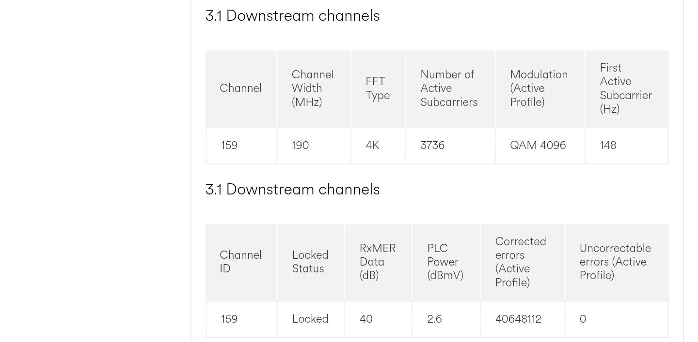

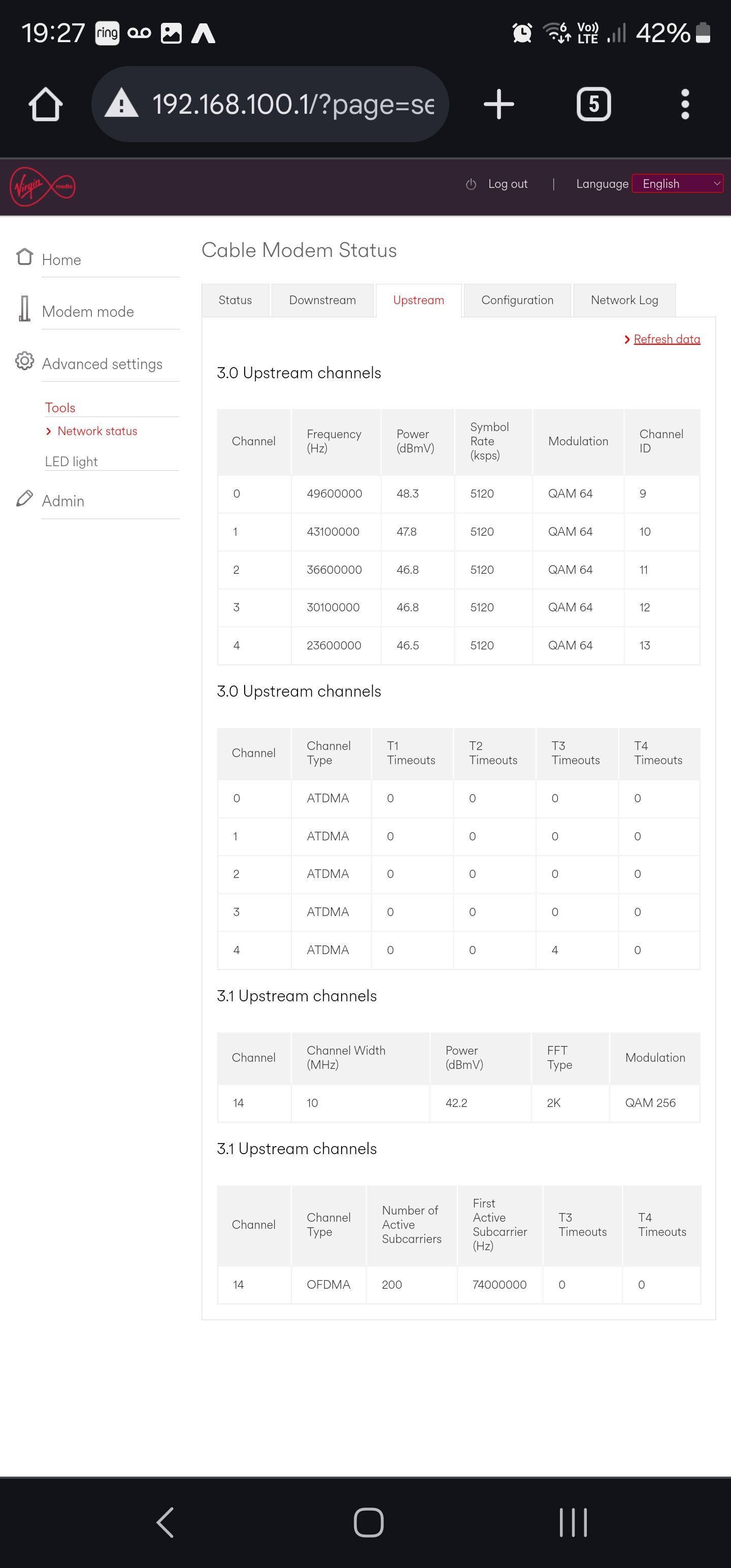

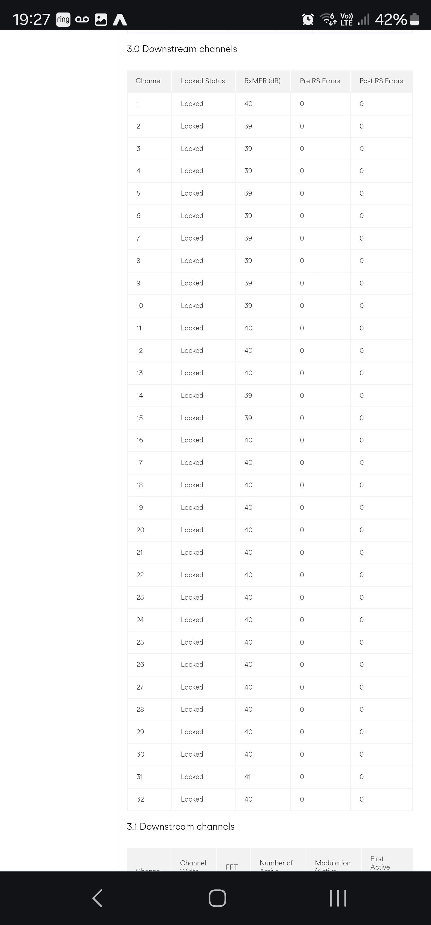

I have had the hub5 set it modem mode since it's been installed with no issues. I have attached some screenshots of the speed and logs etc, any advice is appreciated.

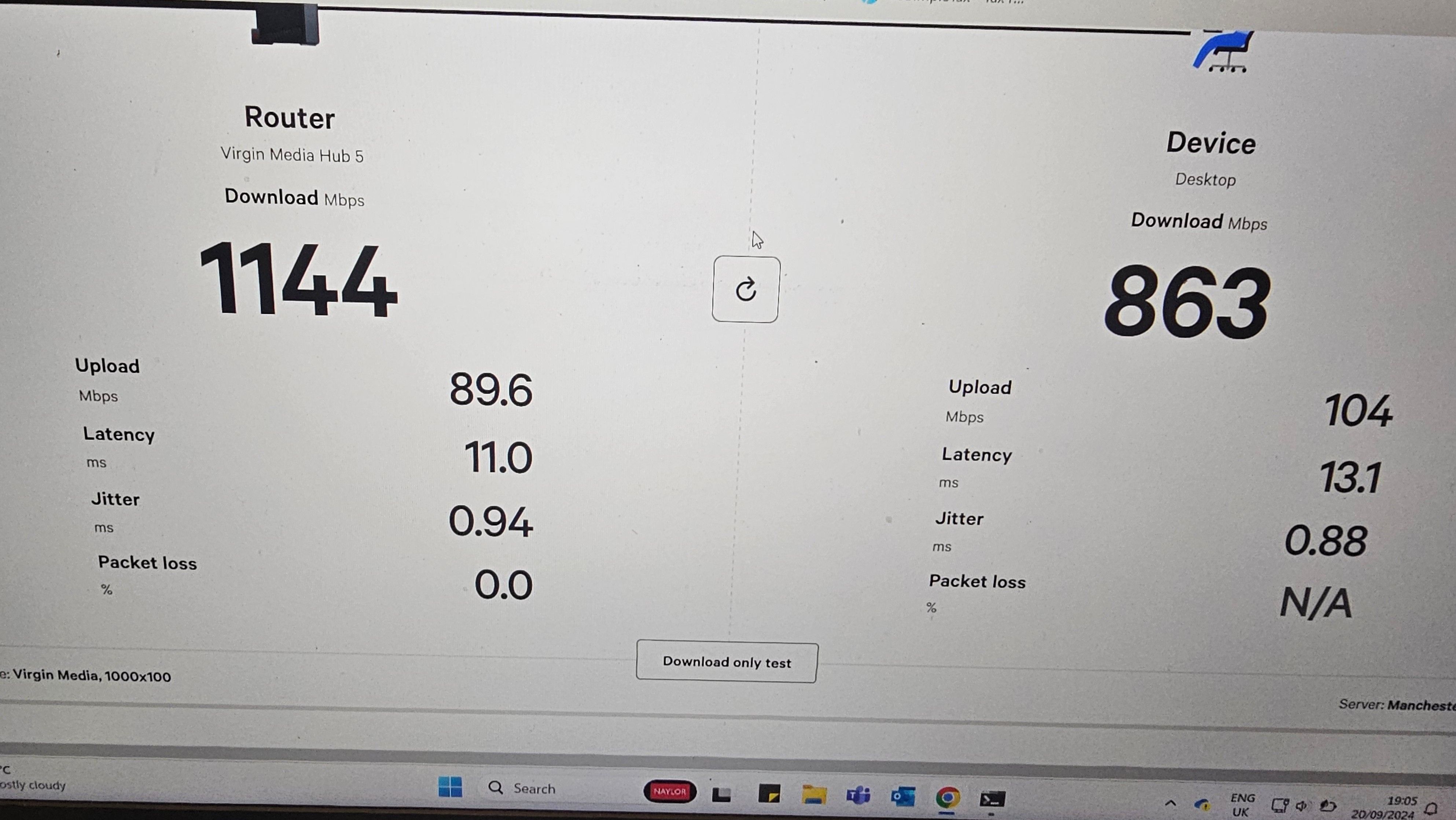

  • The image showing 863 was done on my laptop with a wired connection, the other speed tests were done over wifi
      Jenks88 wrote:
      <snip>   the other speed tests were done over wifi
      It's worth pointing out VM only guarantee 30Mb speeds over Wifi.

    Router stats are difficult to read from screenshots, better to copy/paste as text.

    Strange as you have SamKnows running?  This does not work in modem mode.  Aside from that, SamKnows is showing full speed to your Hub so the issues are on the LAN side.
    • Jenks88's avatar
      Jenks88
      I had switched the hub over to operate as a router while I hardwired into it to run the testing to make sure it was getting the correct speeds.
      Wifi devices were connected on 5ghz (Samsung S23 ultra) sat about 2 metres away from the hub.
      The router I'm using is the Asus RT-AX82U, I should get getting better speeds than 100mpbs over wifi surely?
