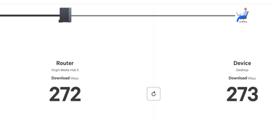

    Try checking with Area faults on 0800 561 0061 or if you have a VM landline 150 as small local faults are not listed on the VM status page.
    Run the FULL tests on this website and post the results   www.samknows.com/realspeed
    Post the power levels, Pre and PostRS errors and network log from the Hub.
    Setup a BQM to monitor your circuit www.thinkbroadband.com/ping
    Check where the devices are getting the Wifi from.  There are reports here of devices using the furthest pod when the Hub is right beside it.  It could also be the Smart Optimisation switching channels on the Wifi bands, and this will cause disconnects.  However there is nothing you can do, as this function needs to be on for the Pods to work. As a temporary test, connect the TV up with a cable and see if it still buffers.
    Once done we can comment.

      I just clicked on the sam knows. Router 279 device 28. U an now confused as I'm sitting about 10 feet from the hub in my lounge.
