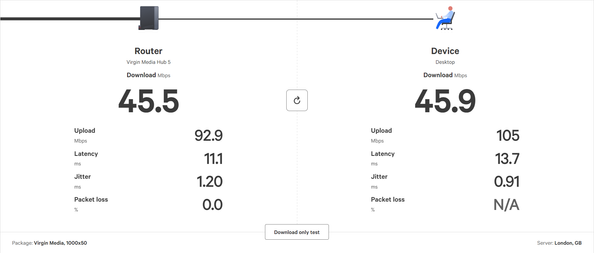

      Here are the results from that website
  • I encountered the same issue where my internet speed was dropping from ~900 Mbps to 1-2 Mbps every 3-4 hours. After few calls, a technician came and found that the issue was with the distribution box. he showed me on his device that some of the channels did not have enough signal strength. He boosted the signals from the Box and my issue got fixed. It's been a week now and my speed has not come down since.
    he also mentioned that some channels were still showing red but they were not impacting my speed. he said that in few days someone from Virgin will come and fix the fundamental issue of low signal for specific channels at the box. Not sure it has been done, but my issue is fixed.
    May be this is something you can tell your technician. Not sure if it is the same issue, but worth mentioning it to the technician. Good Luck!
