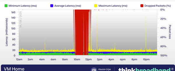

Last week (Thursday 14th Aug), there was an outage in my area while VM upgraded the local Fibre Node.
Since then my DS levels have dropped by 6dB, and US now sending 6dB higher.   In itself this would not sormally be an issue, BUT the SNR on my Hub-5 has definitely degraded on a percentage of the QAM channels.   US channels regularly drop back to 32QAM or sometimes 16QAM.
Yes, I know the levels are "within the standard VM range", but the Post RS Errors are excessive.
Somewhat frustrating for someone who has worked on HFC & Docsis for well over 20 years !!
Someone has not aligned the new fibre Node correctly.  Guess I have to call customer service & chase through the maze of getting them to understand !!
The outage:

    Problem is it works but not 100% or 99.9% fine
    BQM clearly shows small drops then it should
