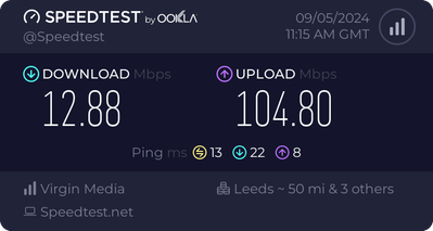

On 5 Sept, I began to notice that webpages were loading incredibly slow, and performed a speed test. The download speed had dropped to 12.88 Mbps, but the upload speed was 104.80 Mbps. I turned the router off, and unplugged it for a few minutes, then plugged it back in. After a while I did another speed test and it was 945.93 and 104.88 Mbps.

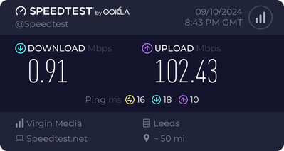

I had the same problem yesterday, 10 Sept, with speeds of 0.91 Mbps and 102.43 Mbps. Again, after cycling the router, speeds were 945.98 and 104.89 Mbps.

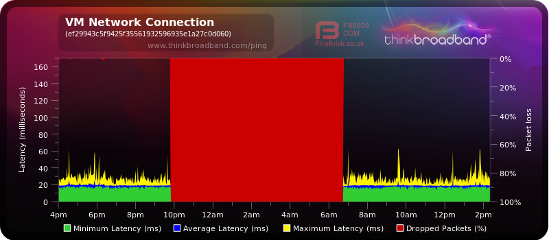

The same problem then hit today, so bad that I couldn't even get speed test page to load. I tried to access the Internet through the Hub 4 router on both desktop (via Ethernet), and on mobile (via WiFi). Both encountered same issue. I finally got the speed test to work on my mobile, which registered 0.10 Mbps download.
I then tried logging into my account through the My Virgin Media app. When I tried to move on from the email login page I got a "Sorry, something's gone wrong" page, with the error code: FSB50. I was able to login to the router (192.168.0.1) and ran the Network Diagnostic Tool, but all this said was that "Your home network has a few problems", without giving further details.
I've had to access My Virgin Media account through mobile data. I ran through a Service status check and received an error for broadband, with an "Intermittent signal in your area" message.
After repeating the same routine (cycling the router), the problem was fixed - to a point. unfortunately, I'm getting 1/2 my download speed, at 437.49 Mbps, while the upload speed is consistent at 104.84 Mbps.
Is it the signal itself, or the Hub 4 router? I can't be expected to repeatedly cycle the router if this is going to be a regular occurrence.

  • jbrennand's avatar
    jbrennand
    Lets see the connection data - see this...
    Post up your Hub/network connection details and someone will check to see if there is a problem there.  In your browser’s URL type in 192.168.0.1 if in router mode or 192.168.100.1 if in modem mode. No need to log in - just click on the “Router Status” icon/text at bottom-middle (Hub3/4/5) or top/right (SH’s) - of the Login page.
    Then… Navigate to these “data pages” and just copy/paste the normal “Formatted Text” (not images) 3 FULL sets of data onto here – 2 tables from the Downstream, 2 from the Upstream, & the Network Logs pages. Don't worry too much about the formatting it can be easily read & DON’T include personal data or MAC addresses - blank them out - if you copy/paste the data, the board software will do this for you (you may need to click the "submit" button again). If character limits are “exceeded” - just do two posts
    Also, If you haven’t already, set up a free, secure and “offlsite” - “Broadband Quality Monitor” to continually monitor the state of your connection and record any true network dropouts , latency issues, packet drops, etc - it will thus allow you to differentiate between those and simple wifi dropouts. It does it 24/7/365 and it keeps a visual record of any/all of your network disconnections, useful data to have to match to the Network logs (in your Hub settings) and also in discussions with VM - note it will take a few hours to start seeing a sensible picture - post up the “link” to the “share live graph”. Click the lower link (Share Live Graph) then, click generate. Copy the text in the Direct Link box, beware, there may be more text than you can see. On here click the Link icon (2 links chain to the left of the camera icon) In the URL box paste the link you copied and then click OK
