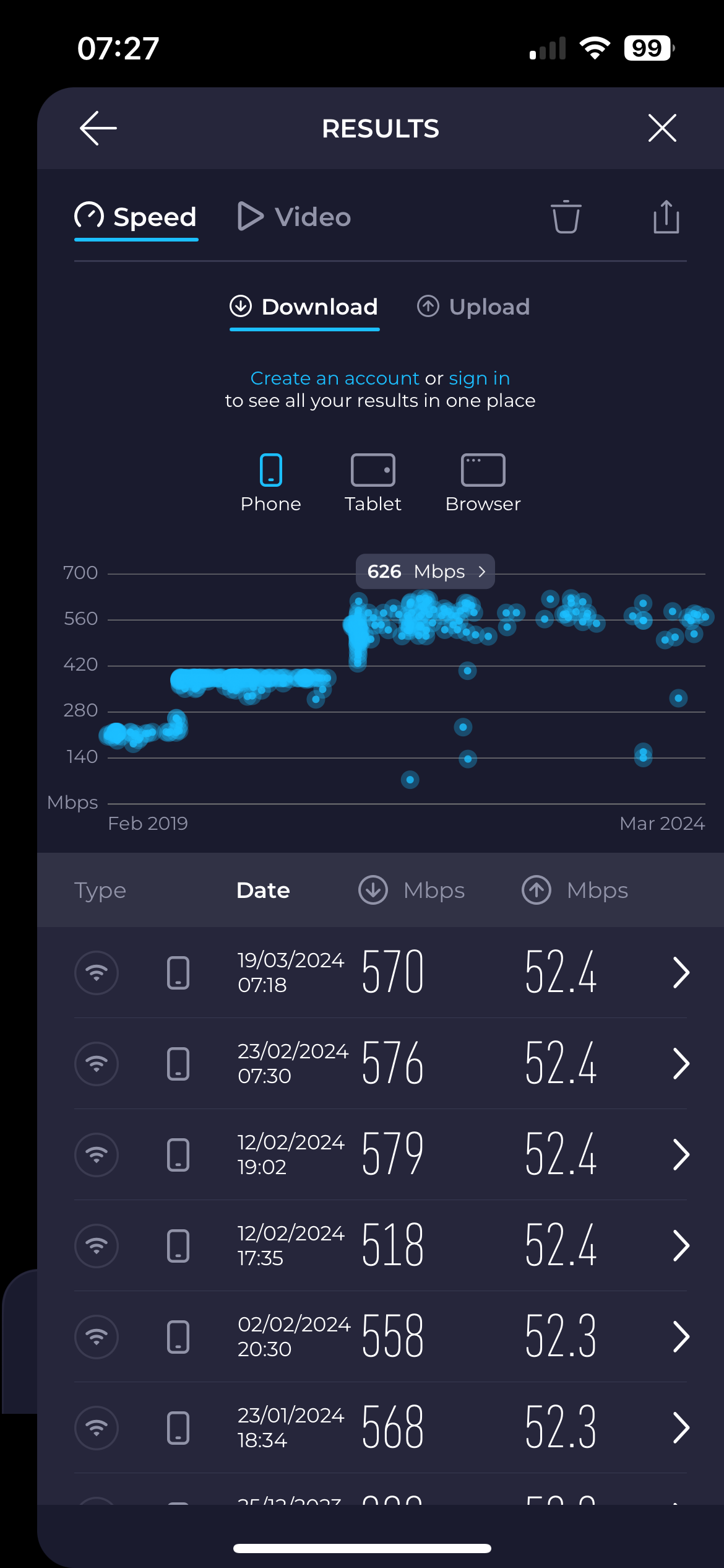

      Wired is perfect around the 650mb,wifi used to be around 500mb on iphone(next to hub)
      i dont have the 2 channels enabled as i have a wifi pod upstairs,if i split to have 2g and 5g the pod didnt work,it was flawless till about a few weeks ago when the area had gone down and a engineer was working on it.(old Oomph package so got a free pod then)

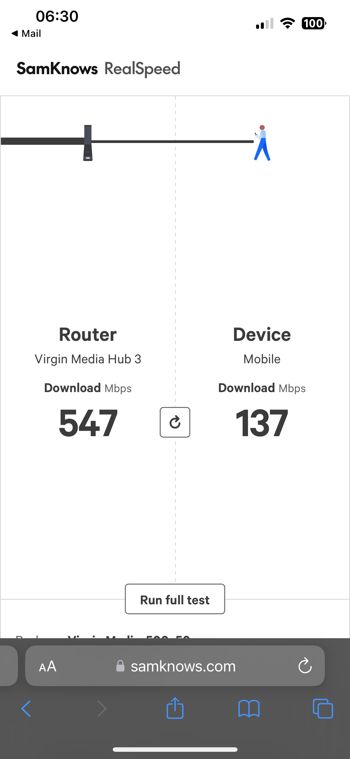

       As you can see was cracking speeds but its now hitting around 100mb on iphone,worse upstairs.

        Hi Karl72 👋.
        Thanks for the images and update on your Virgin WiFi, I saw that you have stated that you do not have both channels enabled, and using a WiFi booster pod, if the pod is provided by us it is essential that both channels are turned on as the pod is dual banded and can support both 2.4Ghz and 5Ghz channels, if it not supplied by us, is the pod that you have a dual banded pod. It is advisable to have both channels enabled as they are required for various devices specifications as well as performance of your home network.
