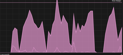

Hey all,
for the past week or so I've been getting ping spikes every day multiple times. This issue gets fixed by restarting router but the issue can happen again. Service status in my area says nothing wrong. Here's a small snippet of network on task manager showing the packet loss/ping spikes.

  • Hi rikeshp
    Thanks for your post. Sorry to hear of the broadband issues you've been experiencing.
    I've had a look on our side and can see that a lot of your levels are outside of the normal parameters which will be what's causing this. We'll need to book in an engineer visit for you to put them right
    I've popped over a PM so I can arrange this with you.
