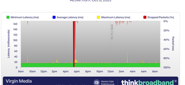

I am getting packet loss on my gig2 symmetrical connection. This is causing calls to drop at work and making gaming almost impossible as I get disconnected from servers.
I believe this is caused by the realspeed testing enabled by Virgin Media. I would like this to be disabled on my account please as it is causing significant issues with my usage that I pay good money for.
9 Replies
  • Had an engineer out last night (you can see the downtime on the graph). Still exactly the same, random packet loss has started again. The engineer was also in agreement it’s likely a network test causing this but he had no option to disable anything.
    Please can somebody help me get this setting changed so that my connection remains stable? I’m a paying customer and shouldn’t be used as a guinea pig for Virgin Media’s statistics :(

      With network testing, this is only done in line with OFCOM requirements. As these checks are mandatory, it's not something we can turn off. Did the engineer advise on what else could be causing this or offer any further advice?
      If not, we may need to look at booking a further visit for you.

        Yes there's an engineer coming on Monday, but other posts seem to indicate there's not a lot an engineer can do for this issue? :(
  • Still having frequent drop outs with teams calls. I really could do with some help getting this fixed :(
      The red dropped packets aren't caused by realspeed testing. If they were then the red dropped packets would only be showing at one hour intervals.
      What actual speed are you getting when you run a full test to the hub and device using /realspeed/?
      Are you using a wired or wireless connection, and are the dropped works calls and gaming problems on wired or wireless connections?
      Which 3rd party program are using when works calls drop?   Are you using a VPN?

        Hey, I'm getting 2100 up and down both to the hub and to the device (give or take a few mbps depending when I do the test). I'm using a wired connection when the calls drop and games lag.
        I've had dropped calls both on Teams and Zoom, all around the same time that the red packet losses show on the TBB graph.
        I'm not using a VPN. :)
