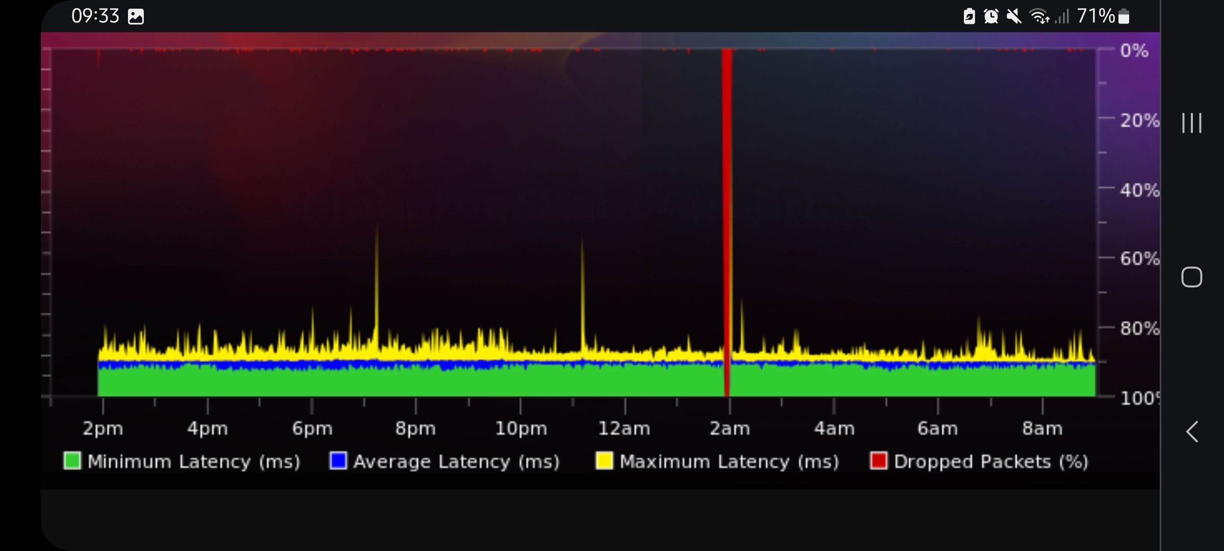

    post your full live BQM
    any spikes on BQM can be caused by you like speed tests without your own QoS/BWM or VM running tests and any spikes when your idle is a problem.

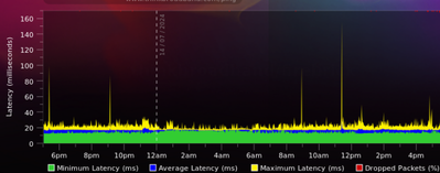

  • JoeC87's avatar
    JoeC87
    I've ran the top URL several times the past week or so and it's always losing then on received ill run more this afternoon when I'm back home.

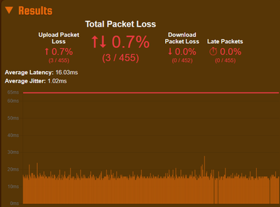

    so this is this evening
    https://www.thinkbroadband.com/broadband/monitoring/quality/share/1bb500d1b8ca86184455d339346deb5c2e8f560a
    this is an average test on packet loss

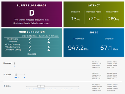

        So it seems the issue had sorted itself out from Sunday onwards in terms of upload speed, but it seems things are taking a turn for the worse again and ever since the 'fix' something didn't feel right in online games, I stopped monitoring via thinkbroadband but restarted it again tonight as something clearly isn't right with online performance, especially gaming.
        This is using Wired connection only, i've tried several different cables.
        this is my current upload speed which has dropped abit since the 'fix' but even since my upload speed went back to normal my latancy has been horrendous.
        notice the Upload Latancy is absolutely dreadful, and i beleive this is causing issues online, i'm getting bufferload spikes of nearly 600ms at times.
