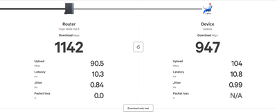

Been getting packet loss for at least 4 months now consistently ,  Currently on hub 5 router mode, upgraded plan to Gigabit broadband, changed ethernet cable and tried tp link powerline adapters none of them yet to fix my issue.
Notes: Gets alot worse when more people are on the wifi. The later in the day the more packets get lost it seems.
(Tests taken at 7pm) currently using an ethernet cable from router to computer for this test.

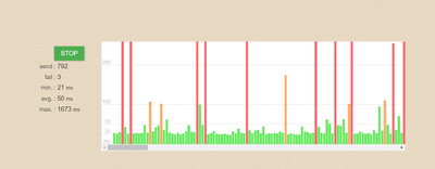

  • I've been suffering with constant stutters.  Mostly like this:
    but also occasionally like this ðŸ˜±
    https://ping.canbeuseful.com/en#ping
    It's no different whether i connect directly to the router or over wifi.  It seems to have got significantly worse in the last 3 months.  I called VM support and they said that the contract I have with them refers to the upload/download speeds, and not the consistency of the signal.  No idea what to do about it, but it ruins online gaming.

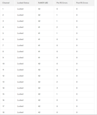

    Now that's interesting.  Your BQM has "red fringing" and that's not a good thing.  Are you seeing any PostRS errors on the Hub stats?  In any event, the circuit has issues.

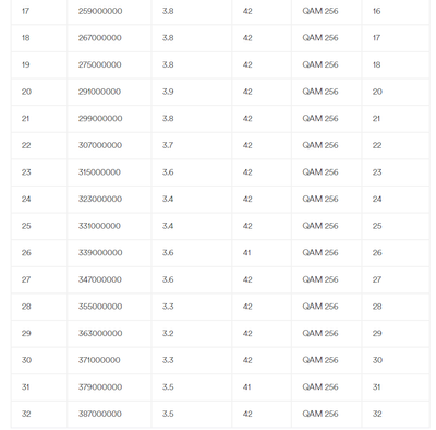

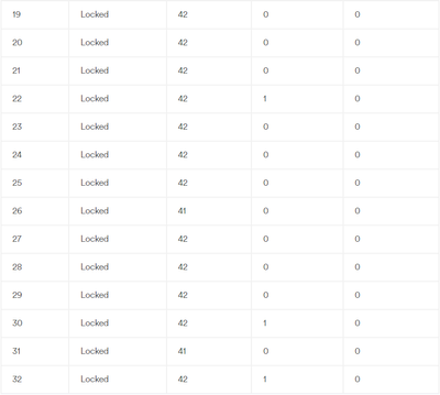

    • Maxtabor1's avatar
      Maxtabor1

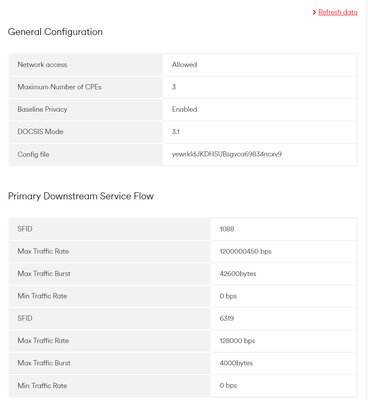

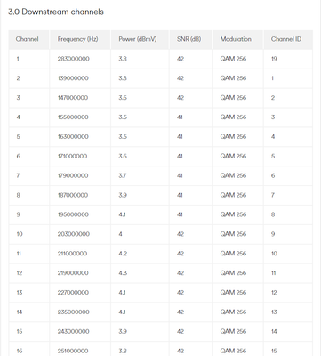

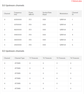

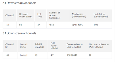

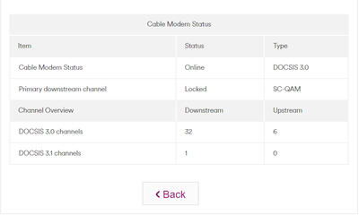

      Hey, im not that good with the some of the intenet meanings and not the greatest with internet in general. So i added all my hub status for you too see if i have any problems with this. thanks.

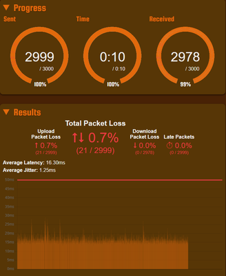

    No packet loss showing on that test, and the Latency and Jitter are pretty good as well.
    That packet loss test in your screenshots, are they over Wifi as the latency is high?  I would expect a certain amount of loss, especially if there are multiple users on at the same time.

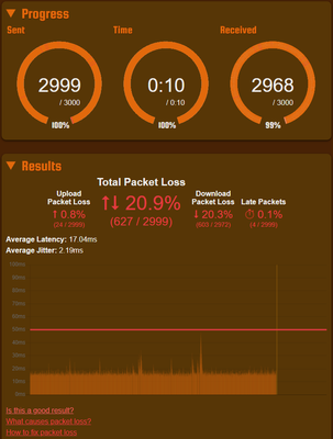

      Maxtabor1
      No, ive done all my tests on an ethernet cable from router to my pc. when i play games like fortnite etc. i get a constant 2% packet loss in the evenings and would spike up to an 20% and stay like that for 30 seconds.
        You mentioned PLA's.  Are these still being used or is your PC wired directly to the Hub with a good Cat 6 cable?
        You should also setup a BQM to monitor the connection  www.thinkbroadband.com/ping
