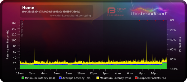

From around 7pm on the evening of Monday 3rd March, regular small 'red spikes' of packet loss began appearing on the Broadband Quality Monitor graph associated with broadband for our home. These have continued for the past week, and are still occuring.
Graph for 3rd March:

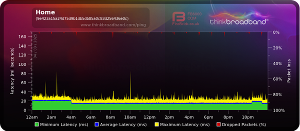

Graph for 4th March:

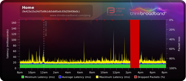

The distance between each spike is quite consistent, at around 70-75 minutes. We've tried restarting our Hub 3.0 twice over this weekend, and each time it hasn't made any difference. It also doesn't seem to have impacted the timing of the spikes, as is shown when looking at the graph for today so far:
If the 100% red block from when the Hub was off was not there, then it looks like the timing of the spikes still matches the same 70-75 minute interval.
