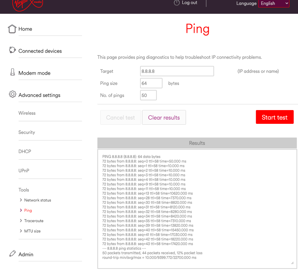

See also attached some PING results made from the hub itself to google.com and google dns @ 8.8.8.8

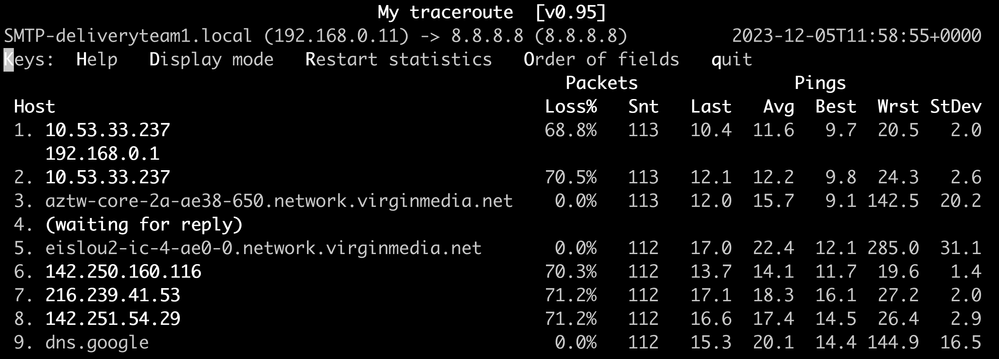

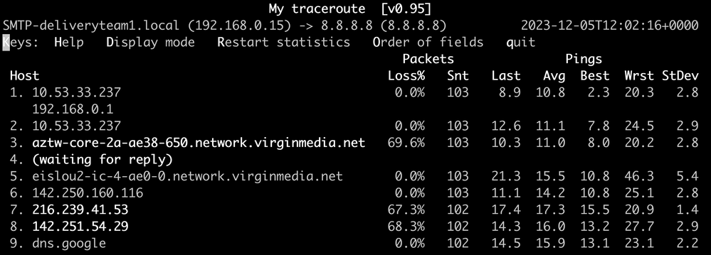

mtr wifi to googlecom
hub ping to 8.8.8.8

    Google Public DNS is expected to respond to NSLOOKUP there is no assurance it will repeatedly respond to PING.
    Perform 50 :  nslookup hp.com 8.8.8.8    see how many lookups fail doing the intended task.
    Use the link below to test for Packet loss at the VM Hub and at your devices...
    Once the test begins click on: Run full test to see Packet Loss, Latency, Jitter, Upload speed.

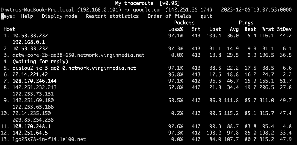

    I've also ran pings to various web hosts, for example google.com (this is the worst one, others like youtube, facebook, etc were better with loss of 0.2% to 3.4% and haha yeah hp.com is all good):
    --- google.com ping statistics ---
    100 packets transmitted, 86 packets received, 14.0% packet loss
    round-trip min/avg/max/stddev = 84.143/497.887/2264.695/587.531 ms

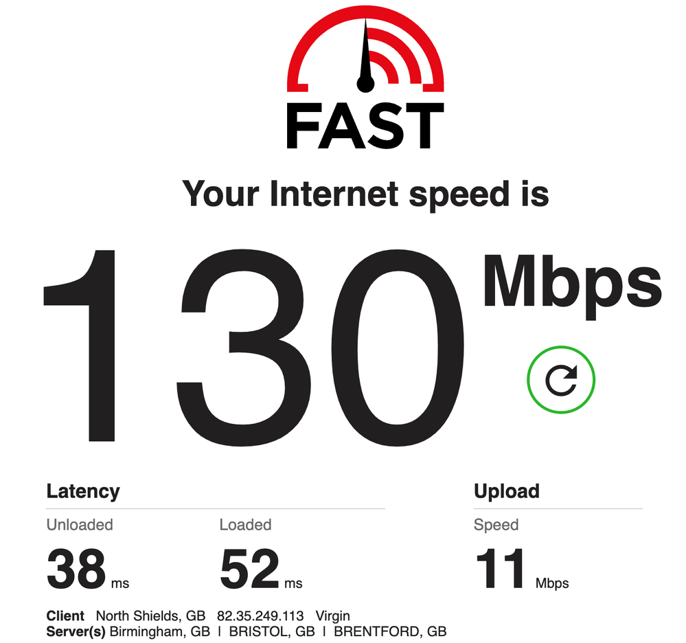

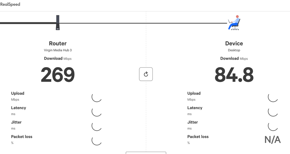

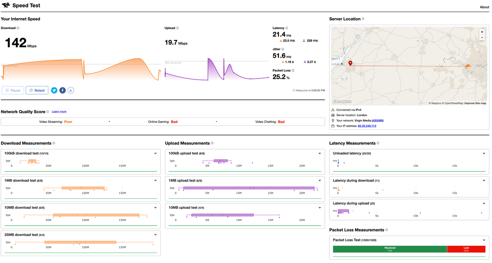

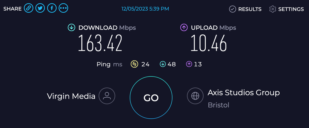

    Various web-based tests show constantly inconsistent results, here is the samknows test you mentioned is below (this is done via WiFi - in the same room, about 2 meters away from the hub with nothing physically in between the hub and the laptop) and no, it doesn't display the 'detailed' results at times at all, but when it does - the packet loss is admittedly zero. It is heavily inconsistent though - the "device" download speed is wildly different in every run - from 30 to 280.
    I also did the cloudflare test (see below) which displays wild variety in speeds and packet loss again. And some other (likely useless) tests. They are all over the place.

    And what worries me is the inconsistency - sometimes it's great and snappy, sometimes it takes 25 seconds for youtube.com to start loading (yes, I timed that). And I worry if I shell out on a proper wifi router and have your hub work as modem only - will it really be better?
    The above stats from the Hub 3 Ping screen are nonsense, look at what happens, the first batch of Hub 3 pings have reasonable response times, but after 20 or 30 pings suddenly the reported ping time jumps by a factor of 1000x to 15,000x reality.  So we go from pings on our LAN at < 1ms to over 10,000ms which is 10 seconds.  Clearly the Hub Ping is not waiting 10 to 15s for a response from a Cisco ATA device that is directly network cable connected.
    For Ping tests, a Command prompt window will provide a reliable batch test
    E.g:   ping -n 100 google.com
    SamKnows Realspeed is supposed to be consent at the VM Hub, and is supposed to show the varying performance of your Wi-Fi device as you move about the home. This you appear to be seeing.
