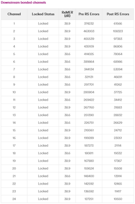

Over the last couple of weeks I've been suffering with 1-2% packet loss, which causes some browsing slowness and dropped connections. I've rebooted my SuperHub 3 a few times but it always ends up in the same poor state.

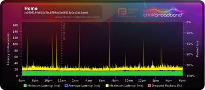

The broadband monitoring shows a small amount of packet loss during the working day when it's in active use:

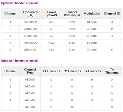

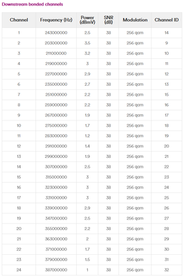

  • Downstream Power levels and SNR are good, Upstream Power is good too, this may not be a fault on your line, it may be a noise issue affecting your street i.e. curing the root cause is a fix for several customers.
    What can be seen in the Downstream are many Pre RS (correctable) errors and worse Post RS (not correctable) errors.  Typical of line noise.
    Looking at the Upstream, normal operation is QAM 64, but we are seeing QAM 32 on 3 channels, fall back to QAM 32 or 16  is again typical of line noise caused by a fault at the Hub or a damaged cable.

    The upstream has deteriorated further with one channel dropping back to QAM 16, so it is definitely struggling. I'll have to try and go through support 😞
