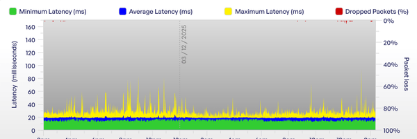

      Thanks for the reply message responded to. And as a note if you want to run tests I cant do router mode for a while as I need to be using the set up I have to be able to work from home till after Christmas. Strange today (reboot of my own router on a weekly cycle at 5am) the packed loss has gone but the signal looks weired
  • fizz's avatar
    fizz
    Fibre optic
    thinkbroadband.com/broadband/monitoring/quality/share/91d463365ae0f9135589f56c62027ff54f4d6e26-07-12-2025.png[/img][/url]
