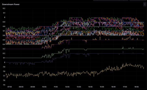

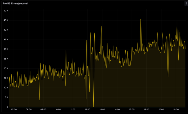

Over the last 12 hours (03/01/2026), the following appears clearly correlated:
  • As downstream power levels rise,
  • Pre-RS error rates increase significantly, and
  • Latency and packet loss increase on the ThinkBroadband BQM
This is visible when comparing:
Grafana modem stats (downstream power + Pre-RS errors)
 BQM (latency, jitter, packet loss)
The rise in errors and latency tracks the downstream power increase very closely. When downstream power stabilises or drops slightly, error rates and latency reduce accordingly.

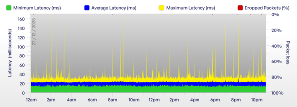

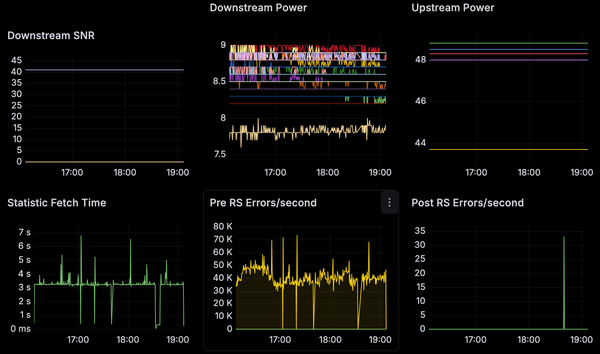

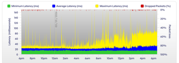

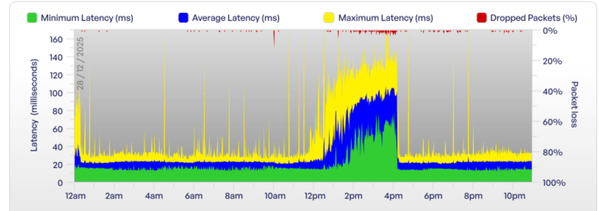

      Yes. Here is the last 3 hours:
      On 27 Dec BQM show minimal ponacket loss:
      on 28 Dec this happen:
      Another user posted a similar BQM and posted a social media link suggesting the more users expereincing similar issues at the same time: https://community.virginmedia.com/discussions/Speed/connection-issues-north-east--west-according-to-xtwitter/5689369

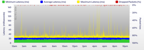

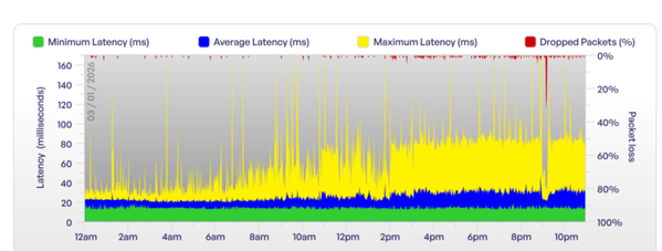

      Since then there is more packet loss daily - on the 2 Jan:
      Then on 3 Jan this happens:

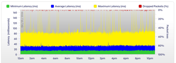

      an since the 4th my BQM has looked liked this:
      On 3 Jan downstream power level became out of spec and have stayed out of spec.
      Upstream is in spec but there is no alot of headroom
      • gitty's avatar
        gitty
        How do you define out of spec? VM has 10 dBmV/8 MHz as an operational threshold, which is below specification (wiggle room). It is not the breaking point. I don't see any evidence that the modem's receiver is being overloaded. I think you can put the receive power aside for now in your quest.
