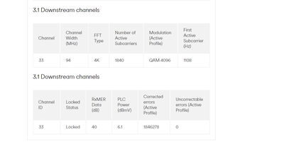

DOCSIS 3.1 Count of Uncorrectable Errors shows as Zero.

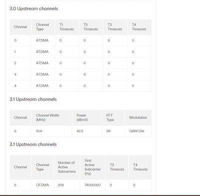

It's possible for an OFDM channel to have zero uncorrectable codewords. The most interesting thing is the reported frequency for the OFDMA channel.
- IPFreelyRising star
Anonymous wrote:It's possible for an OFDM channel to have zero uncorrectable codewords. The most interesting thing is the reported frequency for the OFDMA channel.
It is right up there going all the way to the mid-split diplex filter roll-off. I wasn't aware they were using the extra return path in the mid-split areas, thought it was all crammed under 65 MHz, but clearly they are.
200 Mbps upload is certainly feasible in mid-split areas.
- In ReviewAnonymous
The channel width hasn't changed though, so I wonder if it is a display bug.

what is this corrected errors field mine is massive!
3.1 Downstream channels
Channel ID Locked Status RxMER Data (dB) PLC Power (dBmV) Corrected errors (Active Profile) Uncorrectable errors (Active Profile)159 Locked 38 -3.2 1269097399 0 - snozskiUp to speed
Mine is same yep
The huge number of corrected OFDM codewords is by design (it is normal), so it doesn't indicate failure.

"One thing that we were able to demonstrate during our testing is that the LDPC error correction algorithm is so powerful that we can see 100% correctable errors and still run error-free with some margin left before dropping the modulation."
it is standard operation. Higher modulation > higher throughput. Let the powerful FEC fix the errors. You cannot tell from the counter how many error bits there are per codeword (how hard it must work). A single flipped bit will result in a corrected codeword (these codewords are also much bigger than the Reed-Solomon codewords used by the SC-QAM channels).

Interesting topic, over my head admittedly. It may explain why my Hub 5 is reporting huge numbers of Downstream PreRS errors? The actual circuit seems to be fine in speed tests, BQM etc. so I'm not overly bothered.
I've asked VM to check their end for anomalies and await the reply.
It's only normal operation for the OFDM channel. It doesn't explain why half of your SC-QAM channels behave like that.
