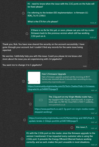

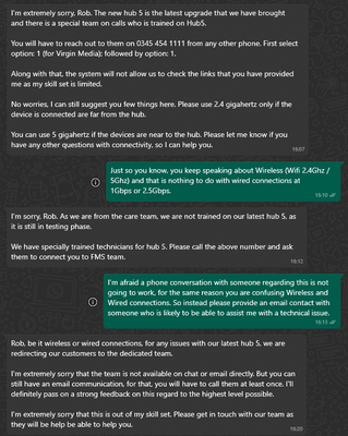

    It's incredible how they do this and then simply ignore the outcome.
    They probably have a threshold of tolerance, so unless it generates over X thousand support tickets then <this is fine> meme.
    To top it off, when you do try to get it resolved, they then stick people on their support channels who don't even know the difference between 2.4GHz Wireless and 2.5Gbps Wired connections... and are not even trained in their main product. The very product you just answered 20 questions to get through to someone about.
    Give. Me. Strength...

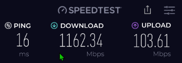

      Speedtest Warwick to Nottingham, have noticed an increase in speed over the last 5 days 1140 to 1160, some Geeks I speak to say the contention may have improved.
