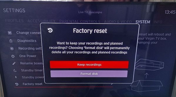

        The box you received was very possibly a refurbished box and not a "brand new" one. Not sure why you didn't have the "keep recordings" option if you have the box on the left in the picture below.
  • TaniaB's avatar
    TaniaB
    It is the box on the left. I don't know why they would send me a refurbished box especially when it wasn't a like for like and it did still have the plastic film on the front of it.

      There should be two options when selecting Factory Reset - you won't see them both until you actually cIick  on Factory Reset and then enter your Pin number, then the next screen will open (The box default pin number is 1234)
      To factory reset go to Settings (the cog at the end of the Home menu) > System > Factory Reset. It's actually misnamed and only a partial system reset and not a complete factory reset. You are given 2 options
      Keep Recordings
      Format Disk
      Choose Keep Recordings, which means you won't lose your recordings, and any planned recordings, or series links you've set up. You may have to sign into your apps such as iPlayer, Prime, Netflix and ITVX again.  Also Match frame rate and Standby power consumption may go back to their default settings if you have changed them.
      (To be honest if you have already lost your recordings then you have nothing to lose by clicking on the second option Format Disk)
      If this doesn't fix your issue then your box will need swapping out.
