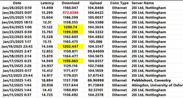

    Just for reference I have a Ubiquiti UDM Pro router connected to the Hub5 via Cat6 Ethernet cable into an SPF+ adapter on my router that support 1/2.5/10G. Daily Speedtest shows similar to:
    Nov 25 04:28:28 linkcheck[840]: linkcheck[840]: linkcheck.run_speedtest(): Completed: Downlink 1156.000 Mbps, Uplink 105.000 Mbps
