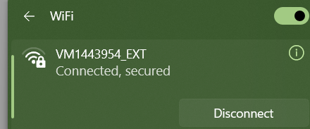

"except one room, my parents decided the best idea was to install a Pod in said room,"
This is exactly how not to place a VM Pods or any Wi-Fi Repeater.
Move the VM Pod / Repeater to be between the VM Hub and the room needed coverage.
The _EXT WI-Fi SSID is usually the network from a retail Wi-Fi Repeater.
The VM Pod typically maintains the same SSID as the VM Hub. - AdduxiVery Insightful Person
It is also quite common for a non wired backhaul Wifi extender to half the speed of the existing Wifi.....
Are you sure this "extender" is a VM Pod? The old VM PLA extenders, I believe, used to use the _EXT name when setup.
- Client62Alessandro Volta
Indeed that does look like a power line extender ( not a VM Pod ).
Is the other component of the Powerline extender connected to the VM Hub via a network cable ?- MFegJoining in

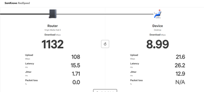

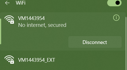

The Hub was moved into a hallway where it would wifi would be better distributed, but this changed nothing, as the main VM network was still unusable and the _EXT one remained incredibly slow, while also being the only working one,
As far as I am aware the Pod we use is NOT a PLA extender, it is one of the hexagonal shaped wireless pods that are plugged into the wall. Despite this, the _EXT network remains, and is still the only one that can be connected to...
