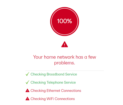

    all devices have different IP's. when accessing the router via my browser the network status has a few "GUI Login Status - Login Fail from LAN interface"  Notices and the network diagnostic tool always gets a red triangle warning on the ethernet connection. I'm buying a new ethernet cable today to test that. A pc engineer said he thinks it may be drivers but I've just done a clean install of windows and the problem persists... it might go an hour before it disconnect the internet or 20 times in an hour.... I will try other things before buying a new router.

    I'm not sure if it is a pc issue or a superhub issue but I do get this

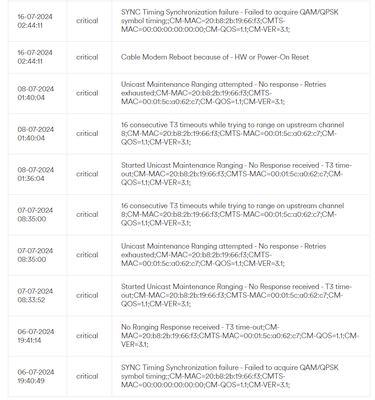

    And the only critical issues  in the network log are these

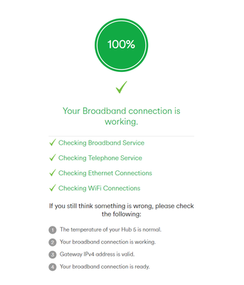

      After some trial and error, I thought I had solved it when it appeared that if I do not use the top ethernet port on the superhub then everything appears to be good when checking (as seen below in the image). But checking a moment ago it still shows ethernet problems and my internet still disconnects so I shall leave it on overnight and it is being diagnosed tomorrow (monday)
