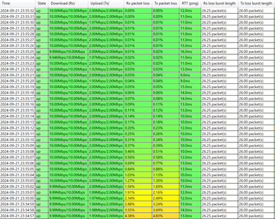

Since then, I have been noticing Teams calls dropping while I am working and occasional lagging while I'm playing games. I used packetstats.com to check the stability of my connection and it looks like every 5 minutes or so there is a brief second or two seconds when the connection will drop completely.

  • I've set up the BQM. In the meantime, this is a screenshot of an app I am using called StarTrinity Continuous Speed Test.  It sends and receives a small amount of data every second to check packet loss etc. You can see at 23:34.57 the connection dropped and lost packets for a few seconds before recovering again.

      Welcome to our community forums and thank you for your first posts. Sorry to hear you have been having service issues since upgrading your Hub. We can understand the frustration caused and we want to best help. We have run some tests and we can see there may be an issue with your power levels. To best look into this, we are sending you a private message. Please keep an eye out for an envelope at the top right corner of your Forum page. Let me know if you have any issues locating this.
    The stats all look fine, I would guess they were taken after a Hub reboot?  There nothing in the logs, again just after the reboot?  Keep an eye on the stats and log after the Hub has been on line for a day or two.  Things like Sync errors, lots of T3's, PostRS errors etc.  Also post the link to the "shared graph" BQM for comment.
