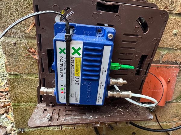

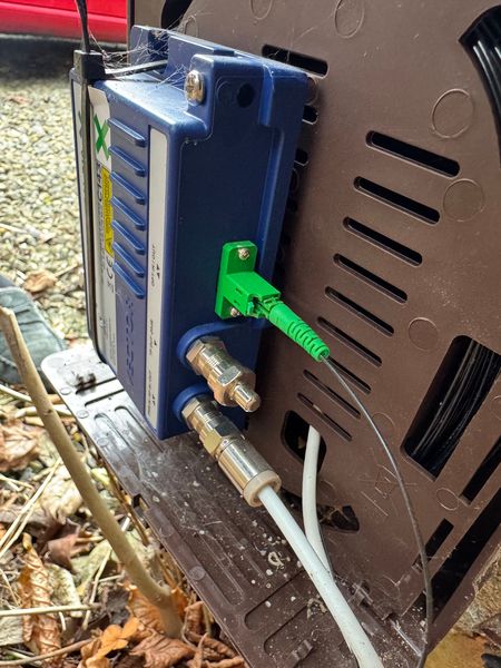

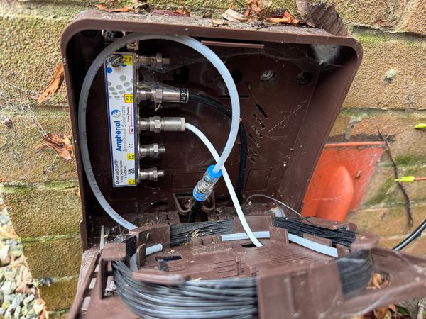

A company called Avonline were working on the cable box outside yesterday and since then the internet has been down. I've done all the checks internally with connections and decided to look inside the brown external box.
It shows the OPT IN light as red. I've attached a couple of pics.
What could be the issue and what can I do?

    Green light shows you have power to the media converter. Red light shows an issue with the fibre optic connection to your home. Don't think there is much you can do about that other than wait for the VM tech.
    Keep notes of everything for the purposes of any compensation which might be due

    Liable to be an "in cabinet " issue, so not a lot you can do. They have either knocked or broken the connection or disconnected the wrong fibre.

        A VW engineer arrived on Friday the 7th of February 2025 at 2.30pm. I explained the timeline of Avonline working in the street 5 days earlier and our broadband losing connection at the same time.
        He checked out the brown box confirming that there was no connection. He then proceeded to check the lines leading from the grey junction box further up the street as well as the underground junction. He found a couple of wires which had faults.
        The engineer, Dave Morgan, was excellent throughout the whole visit and managed to get the external work approved and for Avonline to come out asap to fix the issue. I was very dubious that this would happen, but they came out an hour later and apparently removed the old cable and 'blew a new one' Happy days... eventually.
