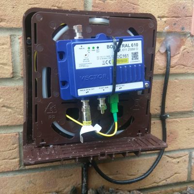

Wifi connected but no internet
Wifi been down all day, router flashing red, tried restart etc but no joy. Also no problems in local area (next door's virgin is working fine!)

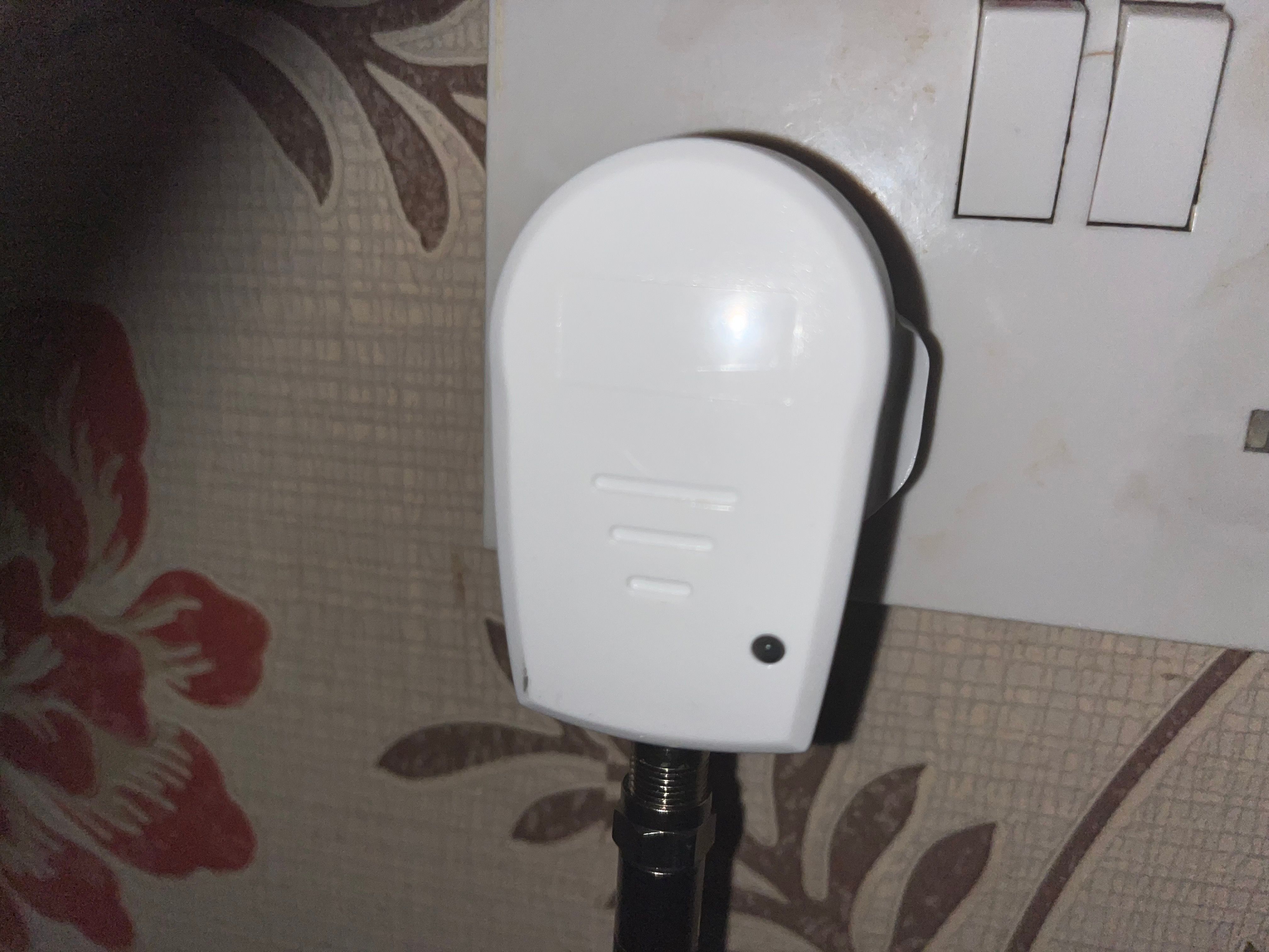

Think problem is with this below as it is not showing a light, sure there was a green light previously?
Any ideas?
  • That the powered amp and it should have a green light. You will need a technician to fix this.
6 Replies

  • Correct, that adapter powers the Fibre to Coax 'box' outside your home, required in RFoG (Radio Frequency over Glass) areas:
    We are an RFoG connection too, the green LED should be lit.
    Get an engineer to visit you, just report the service has failed & VM can tell that from a remote test.
    In the past VM's offshore telephone support had no clue what this ONT PSUs are
    and may send a Hub PSU, resulting in an on going delay.
