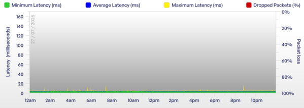

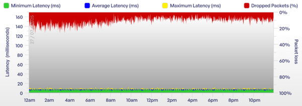

I've been having persistent packet loss ever since getting on Virgin Media, thankfully I still have my old connection so I can show a comparison:
Here is the old connection from Home Telecom:
And, in contrast, this is Virgin Media:

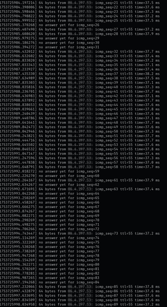

In practice this manifests as annoying, intermittent drop outs out of calls or any sort of online games. The BQM chart only shows the "average" over time, but in practice if an external server is pinging my router it looks like:
Where you can see large chunks of time with consistent drop out, leading to averages that look like:
This varies over the day, but it never fully goes away. I am at a loss at what I can do about this.

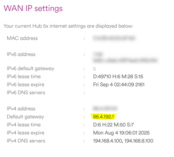

      really a VPN fixes that  packet loss seems odd but then it can be a routing problem and your VPN routes around the problem.
      see what happens if you ping 194.168.4.100 for a bit or if you know the WAN IP gateway that too
      • VenTooth's avatar
        VenTooth
        Pinging 194.168.4.100 seems fine:
        However it does seem like the WAN gateway may be the weak link:

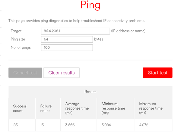

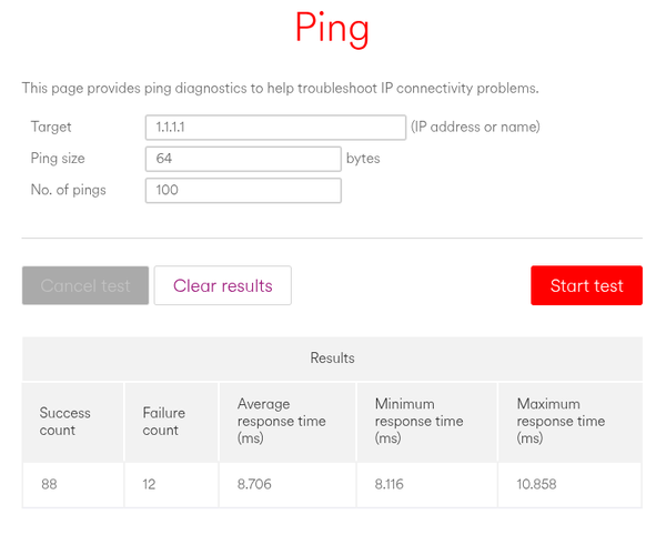

    It's been a little over three weeks since I started this post, and honestly I wish there was a way I could leave Virgin Media without paying the extortionate exit fees.
    Not to mention on top of all this I've had a full loss of service for the past day and a half, just came back a few hours ago and I was excited to test it to see if the problem had gone away.
    Pinging the gateway on 84.4.208.1 still has packet loss. Same deal happens with 1.1.1.1 and same dropouts occur when using Microsoft Teams.
    I've even gone as far as to figure out how to use the ping tool from the router to find the same results:
