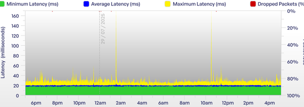

Miserable latency, Sperodic packet loss, Post RS Errors, Pre RS Errors - HUB5 1gb service
So i've been experiancing poor latency maximum latency on BQM is generally 60+ consistantly, overall very strange gaming performance.
for some reason BQM hasn't logged anything since 21st? fully dropped for week+ but i've had internet, so unsure whats happened there

    post your live BQM you may need to update your IP for it
