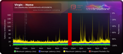

BQM from today (Sunday), I have been having heavy jitter between 4pm and 8pm:
Live BQM graph: https://www.thinkbroadband.com/broadband/monitoring/quality/share/3df506065f2ed90fc507dbf59591946f2584e0c0

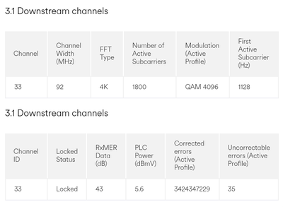

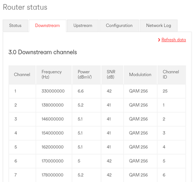

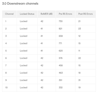

See screenshots for channels after a modem restart, there are no logs around the time jitter was happening today:
(edited mac addresses below)

    That BQM was when you had the old Hub 3. Your Hub 5 will have a different WAN IP address. Did you change the BQM to the new IP?
  • Yes, the same BQM monitor has the new external IP now. This is after this red mark on the chart yesterday, while the Hub was being swapped. So, before the mark is the old IP and Hub 3. After the red mark it's the new IP and Hub 5.
    The screenshot I just sent from today is with the Hub 5 the whole time. So not sure why there were a lot of spikes yesterday, but haven't encountered actual perceivable issues yet. I'll report back if I have packet loss issues. And thanks for the replies!

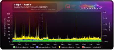

  • There has been a similar pattern of packet loss since my last message 3 days ago and that is disturbing my work meetings. I just restarted the router now. Most recent BQM:

      Thanks for coming back to us with an update and for rebooting the equipment. Checking things again today, there is no raised area fault affecting you however some of the signal levels to the hub are too low. There are also still a number of errors being recorded. We won't be able to fix this remotely so I would like to arrange for an engineer to come to take a look at this for you.

    Cable replacement around 15:00 on Wed, there's some packet loss and latency spikes after that:
    Some drops over the day on Thu and high spikes for minimum latency between 16:30-17:00 when the video call was stuttering:
