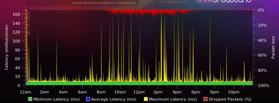

Is this a good connection..appreciate your feeback
Hello all
This is a typical monitor for me...is this bad???. I have seen some people with a smooth green.

  • Well looking at that data there's nothing on your connection to explain the packet loss.  The obvious conclusion is excessive contention in your area - too many local connections.  Since it's happening during the day rather than evening, it looks more like business use than domestic streaming and gaming.
    You could try reporting this as a fault, and see if VM can do something about it. Otherwise, you seem to have alternatives available,

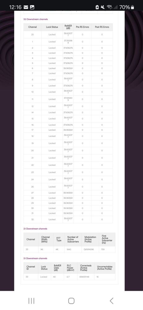

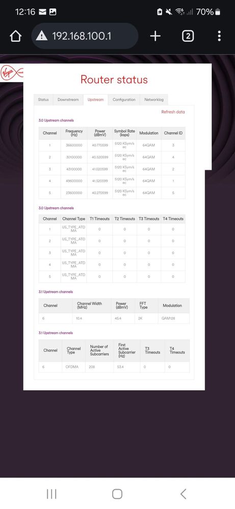

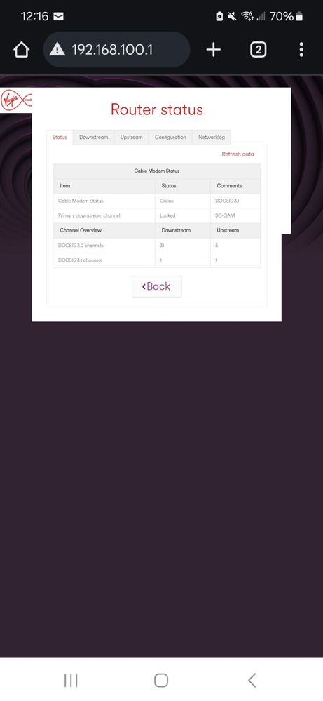

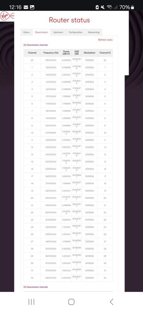

    If this is your IP then yes it's a very poor connection. The packet loss is unacceptable. Can you post the Hub data so that we can see if there is a problem there?

      The signals all within range that may explain very reliable connection. Until recently VM was the only to get anything faster than FTTC 35Mbs. Some are slowly jumping ship..my opposite neigbour had Openreach engineer instal FTTP couple weeks ago.

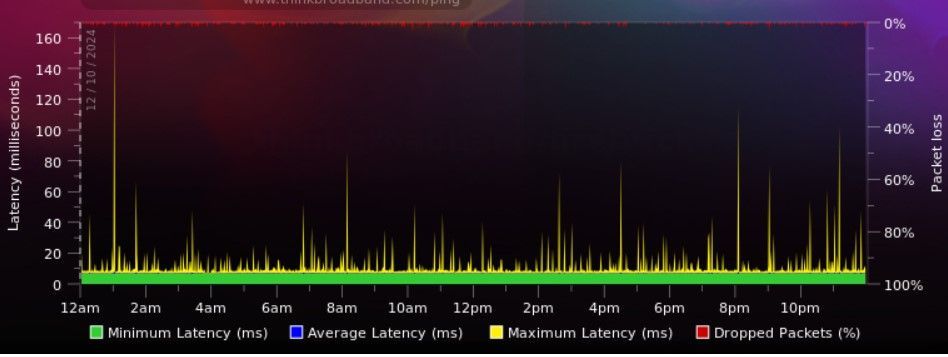

      This is Sat graph..no homeworking.

        You could try this, it worked for another poster a few days ago.
        ___________________________________________________
        There is another possibility, there have been several threads on here recently where similar BQM latency/packet loss problems were eventually pinned down to a dodgy piece of connected kit affecting the connection . Bad connectors on ethernet cables, NAS Drives, CCR PVR’s and faulty network switches being high on the list of culprits.
        What I advised was... if you run the BQM for 24h to get a picture of the issues (you have already done this) - and then unplug all the ethernet cable connections from the Hub and just let it run - overnight is best - then in the morning look at the BQM and see if it has cleaned up. If it has - plug the devices back in one at a time for an hour or two until the problem reappears and that should indicate where to look for what is causing the issues - Start by changing to new good quality ethernet cables, minimum of Cat6a spec.

    Your suggestion is a good one John, but the OP's trace is clean outside of working hours, and if he disconnects everything during the day when the problems occur he loses work. 😞
