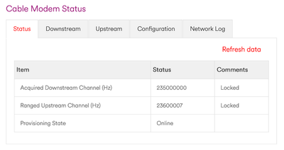

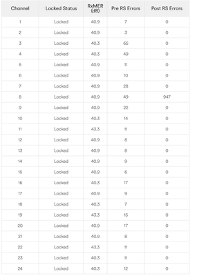

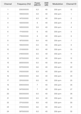

As per the title, I have a 350Mbps connection which has been working swimmingly for months but noticed sometime last week that things were significantly slower. Did a speedtest which came in at 95Mbps and have done one multiple times every day since and they're all coming in at 99Mbps or less.
Would appreciate some insight, not sure whether router is getting the correct config, have done the standard turn off and on again, will post network log below 🙏
