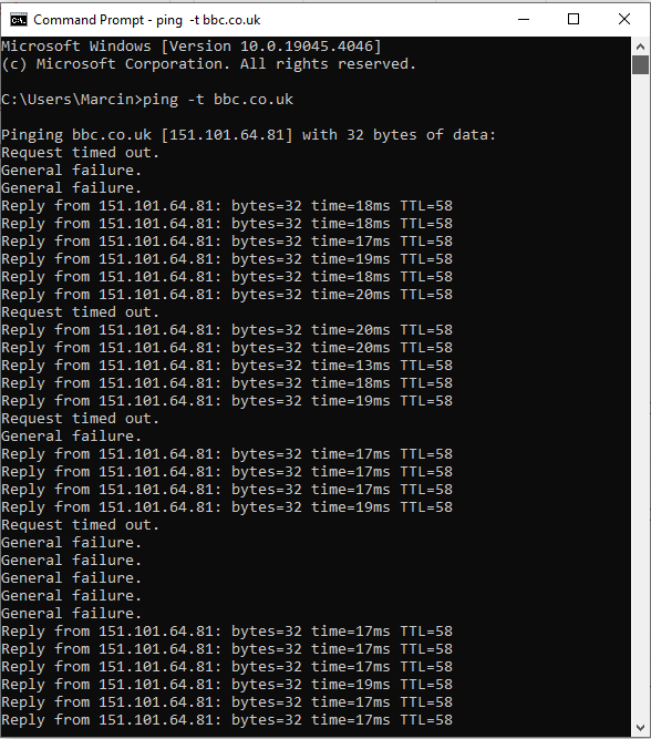

I have been with Viring Media for the past 5 years and I noticed the issue about 3 years ago. The internet will work fine for a few hours straight until it starts to drop. The lost connection is intermittent, it will work for 1 minute just to stop for 20-30 seconds and again and gain from at least 10-15 minutes and then back to working again for another few hours.
I am attaching some data that I have seen was useful on other similar threads.
When I experience the issues I see this when pinging bbc. The Windows tray icon will show no internet.

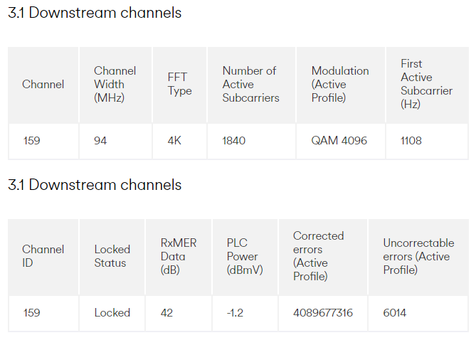

These were taken from the HUB when the internet was working fine, I can try to capture when this is happening if needed.
Downstream 3.1
Upstream
Does anyone see something wrong here?

        I am sorry that you have been having some issues with dropouts, I have had a look and can see there are some issues in your downstream which require a tech, I can get this booked in for you and will pop you over a PM. So keep an eye out for the little envelope 👀📩

    We have to be very careful reading the results of ping against public websites (or public DNS), the website may be a server farm where not all servers are configured to respond to pings from the public internet.
    It is unusual to see the DOCSIS 3.0 power levels range from -0.4 to 3.7 dBmV  they are all in the preferred range & SNR is very good, but on one connection the power figures are usually all much closer.
