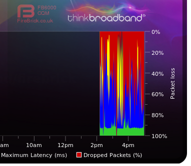

Hi,
Since the morning for the past ~10 hours my internet constantly disconnects every few minutes. I have called Virgin Support multiple times on the phone and they keep constantly going through troubleshooting and telling me it'll be fixed in few hours. But every time I call them they said that there are no details of someone attempting to fix my connection. I'm so beyond fed up already
My friend told me to try the forums, so here I am
I have tried using a service from Think Broadband to check my broadband quality (For reference, a good stable quality is supposed to be all green)
Here is also my network log from the router (Virgin Hub 3)
Thanks

        What Hub model is it? Is it in normal mode - or modem only mode? What devices do you have plugged into it on ethernet cables?
        Can you post up the rest of the data thus....
        _______________________________
        Navigate to these “data pages” and just copy/paste the normal “Formatted Text” (not images) 3 FULL sets of data onto here – 2 tables from the Downstream, 2 from the Upstream, & the Network Logs page. Don't worry too much about the formatting it can be easily read & DON’T include personal data or MAC addresses - blank them out - if you copy/paste the data, the board software will do this for you (you may need to click the "submit" button again). If character limits are “exceeded” - just do two posts
  • The wifi in the hub is the problem.
    I had the same problem, 3 engineer visits, all connections changed inside and out, a hub change and was still getting disconnects. I cured the problem by putting the router into modem only mode. Not had a disconnect since.
