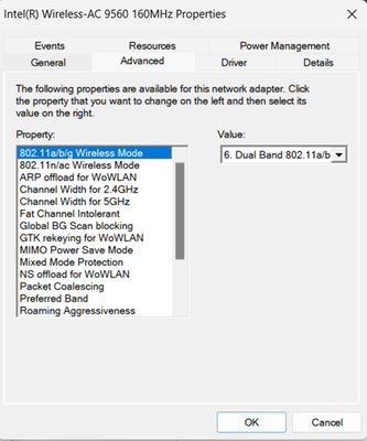

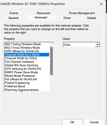

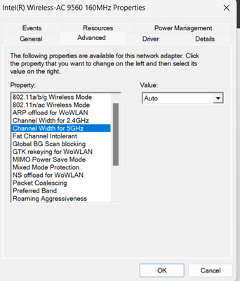

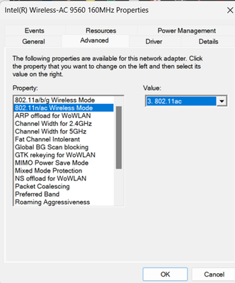

Here are my current factory restored specifications/properties for my Network Adaptor

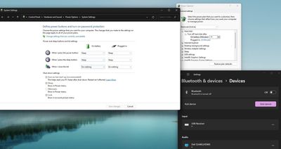

    Also I removed the Bluetooth razer stuff last night from my PC, removed the USB razer and have returned the mouse.
    Also Razer Cortex is not the active power plan anymore.

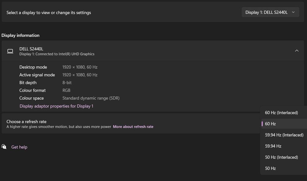

    Have you also tried adjusting the refresh rate of the monitor to see if that has any effect on the interference (if that is what it is causing your problems)?
      This seemed to work for a few seconds quite well - but then suddenly the connection dropped again, unfortunately.
      I've set it 60, the maximum one.

      Unfortunately disabling the 2.4GHz caused the Wi-Fi to go down  and the extender to try and to go through the installation process again. It looks like the extender is using 2.4GHz as when I did a pin reset on the hub itself.

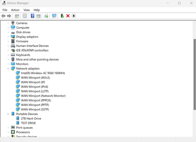

      Whenever I try to change on my device manager to the suggested 'Preferred Band' for 5GHz, I'm not sure if it's saving the changes when I press OK as when I go back into the device manager it's like this again:

    The 'preferred band' setting does not turn off the 2.4GHz wi-fi on the laptop. It tells the device to prefer (and to use) the 5GHz signal when both 2.4GHz and 5GHz are available so the 2.4GHz setting will still be available on the adapter settings.
    When you disable the 2.4GHz signal on the hub the wi-fi will go off (for some 2.4GHz-only devices), that's the idea. You are aiming to test your laptop using 5GHz only and see if the HDMI issue persists when only 5GHz is in use. Forget about the extender for the moment. Turn it off for testing purposes.
    Turn off the 2.4HGz wifi and the extender. Check you have a good 5GHz signal at your laptop before testing the screen. If not, test with your laptop/screen near to the hub (so you don't have signal strength problems) using the 5GHz connection. See if the HDMI screen issue still happens once 2.4GHz is taken out of the equation.
    Your laptop model seems to be dual band capable and wireless AX capable so it should connect to the 5GHz signal without a problem.
    If the problem persists with 5GHz, flip the test process around and turn off 5GHz and test using 2.4GHz only. See if you have a problem using 2.4GHz only.
    If one of the frequency bands works, and is unaffected by the screen issue, use that frequency for your connection. If both are affected then you will have to start looking at other things to try.

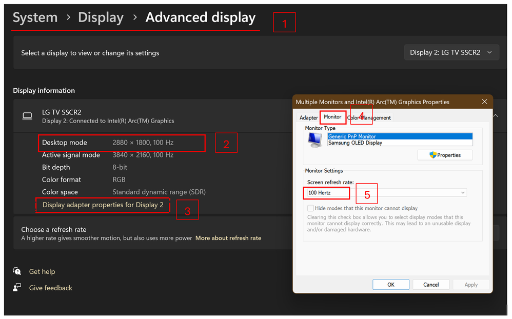

  • Hi - I had the same issue. I have Samsung book4 and I tried to connect it to LG TV through HDMI cable and use LG TV as a second monitor. When I did it, my wifi suddenly dropped. When I would disconnect HDMI cable, the wifi start working again. The following helped me to go around the issue:
    1. For windows 11: GO to System -> Display -> and change Display resolution to Recommended
    2. Change the scale to Recommended.
    3. GO to Display -> System -> Advanced Display -> 'Select a Display to view or change its settings '-> Select your second display (in my case LG TV)
    4. GO to Display Adapter properties for Display 2 -> Monitor tab -> Select your screen -> decrease the refresh rate to 100, 75 or 60 Hertz
    5. Click okay
    6. If you are duplicating your computer screen on your second monitor, it probably won't fit the full screen on your second monitor. You can use settings on your second monitor (there should be buttons for zoom in or zoom out or option on your remote control) to expend the picture.
