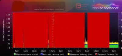

      For some reason the web site will no longer let me add my BQM picture! But it’s basically a red oblong.

      • Jacquimark's avatar
        Jacquimark
        Since the hub / router was change from the hub 5 to the hub 4 the internet has been working fine without any problems. But the BQM shows basically red.
