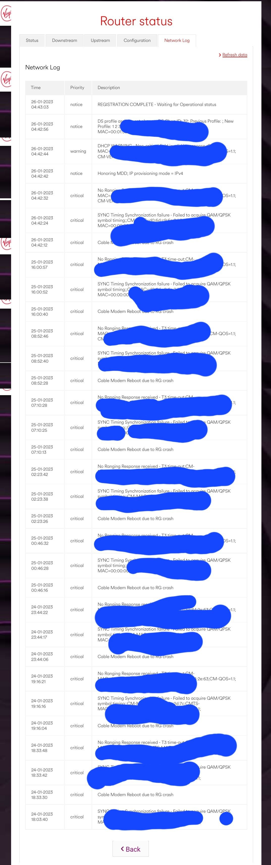

      • anshu83's avatar
        anshu83
        Attached above is a screenshot of my network logs. As mentioned earlier, when this issue happens both wireless and lan go down
