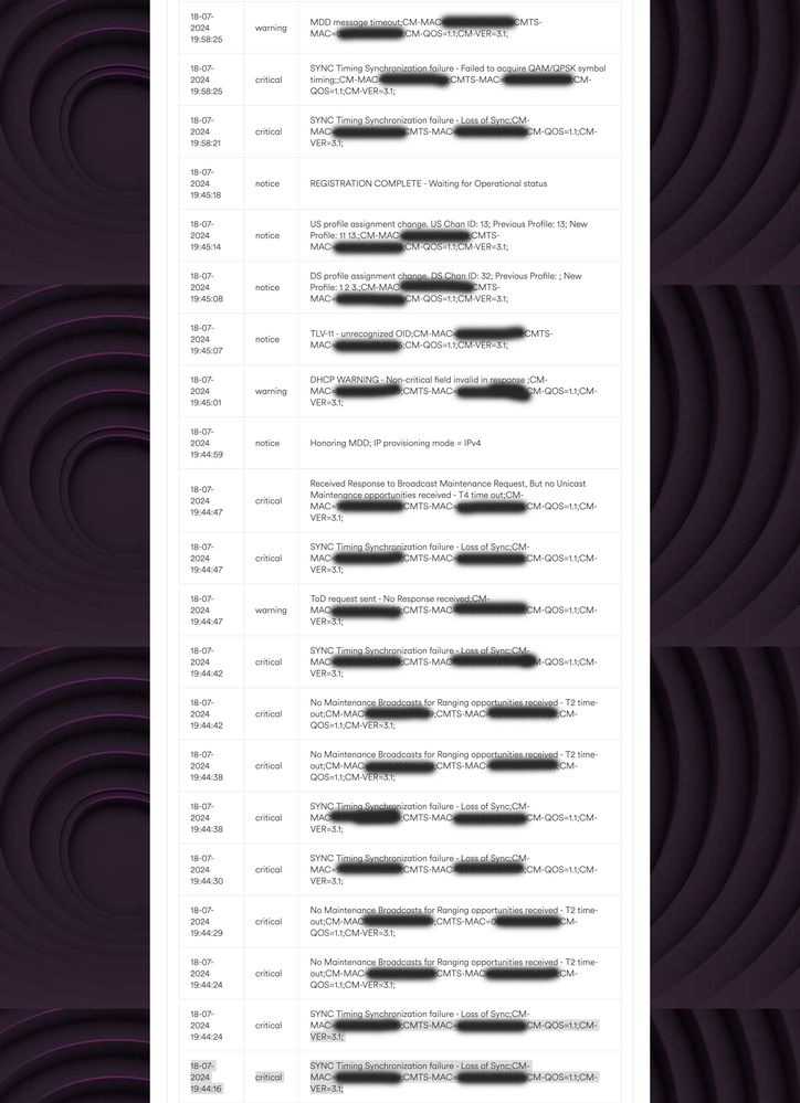

I've been experiencing drops in the internet connection for a couple of weeks.
I've called customer service a few times but they seem stuck going over the same playbook of irrelevant troubleshooting steps like wifi or pinhole factory reset.
I can't get them to clock that something is happening upstream from the router making the connection drop. I can see plenty of T2 timeouts. It can happen multiple times a day for 3-5 minutes and it has been going on for 2/3 weeks now.
I was told they'd try to book a technician but after a second called they told me that it had been canceled since their systems don't see an issue.
I'm hoping in some VM forum folks to pick this up - or someone else to give me the secret phrase to get someone adequate to look into this.
