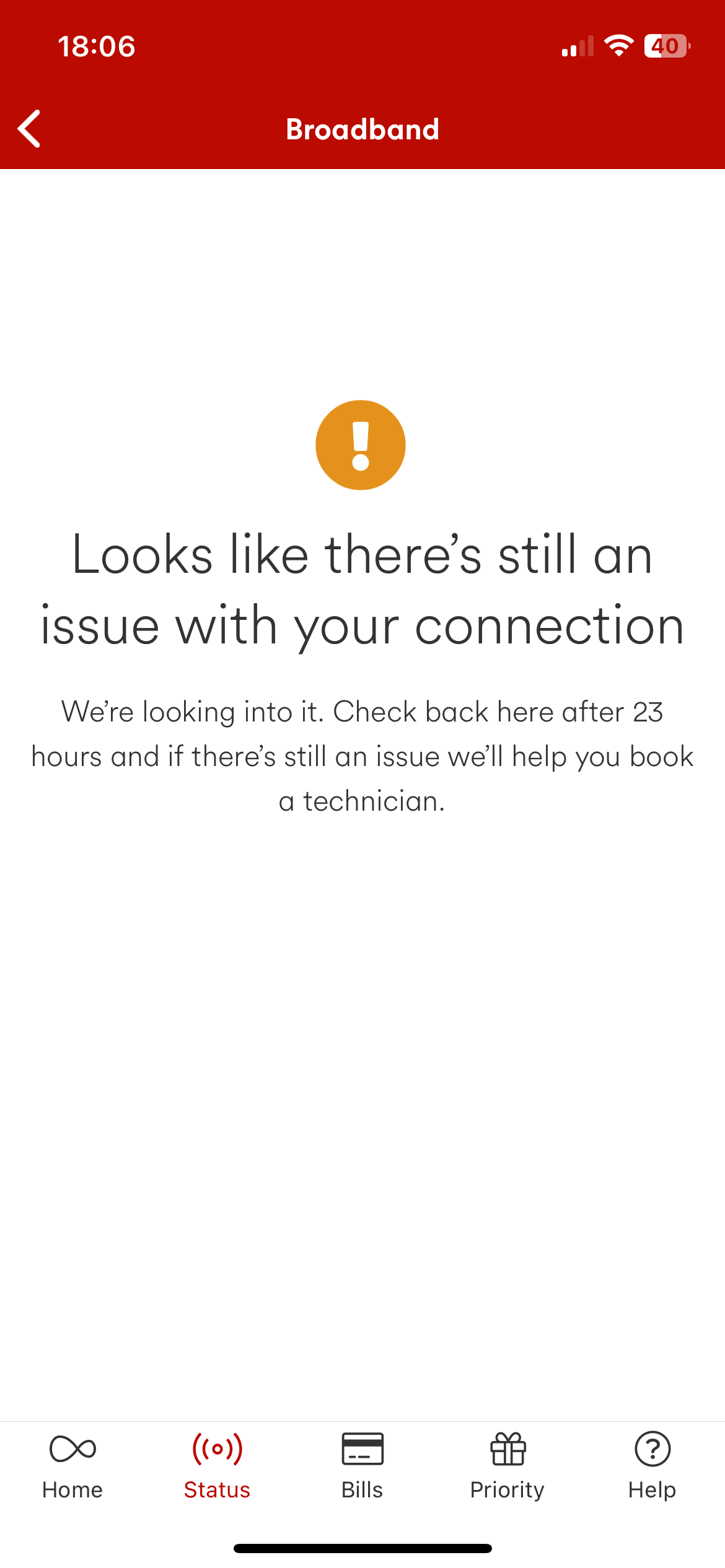

Intermittent frequent ping spikes, rare packet loss and high Post-RS errors
Hi all, hoping to resolve the connection issues that I have experienced since around May/June last year. I've already had 3 technicians come out on 2 separate occasions to investigate and they recommended that I come here. They suspect I need a network engineer to investigate but told me they were unable to arrange this themselves and that I should come here.
The problems began around May/June of last year. Originally it would be minor ping spikes that were only tangible whilst gaming, and would only occur a couple of hours a week. However, over the following months, problems have become more persistent and have started to intermittently affect most areas of internet usage.
Problems/Symptoms
- Working - I work from home most days of the week. Occasionally when a ping spike occurs whilst working the virtual desktop will freeze. If the spike is too long or bad the connection to the desktop will end. At this point, I will have to restart the VPN and log in again.
- Streaming - When streaming live content e.g. sports or TV, live players such as Sky Go will intermittently pop up with a video player error (fixes upon re-open). This doesn't affect streaming platforms that can buffer such as Netflix or YouTube.
- Signing in to online accounts - sometimes when logging into websites like Netflix the log-in request will time out and we just have to keep trying till it eventually works.
- Online Gaming - hasn't been possible in months. Ping spikes are too frequent for fast-paced online gaming. Full disconnects are quite rare.
Broadband Quality Monitor
I think the ping spikes are visible in Broadband Quality Monitor below. Although they feel longer than 160 ms. When pinging using cmd to 8.8.8.8 I can see intermittent spikes up to 430ms and at worst in the 2000-3000ms mark.
My Broadband Ping
Logs have been posted separately in the replies below
House Broadband set up
I do have a switch set up inside my house that connects to the hub, which then feeds all devices (TVs inside the house.) However, these issues persist when the switch is disconnected and nothing is connected to the Superhub except one laptop connected by ethernet running ping/speed tests. (I've tried with just one device connected to the hub and problems persist on phone, laptop and computer)
Attempts at resolution so far
- I've tried upgrading my broadband contract from 500 Mbps to gig1.
- Two separate superhub 5s installed by Virgin Media technician and myself have had the same problem. (And an old super hub 3.)
- I bought a separate router to try running the superhub in modem mode to no effect. Including trying QOS.
- Virgin Media technician tried moving the superhub closer to the brown box to no effect.
- Countless superhub resets, and calls into the call centre where they have sent commands to my hub which haven't resolved the issue.
- I have had a private technician come in and investigate the switch/connections in the house to see if these could be causing the error. He is sure that the problem is outside the property.
Thanks for all your time and help. If there is any more information I can provide, please let me know. The problems have been more frequent and increasingly frustrating since about September so any help would be massively appreciated.

    I’ve been having similar issues where I’m currently on 1GIG and my speed is all good but when I’m playing online videos games it’s laggy and delayed but the games network bar is not showing any spike or packet loss. But the network like keeps going thick and thin where it’s supposed to only stay thin.
    it’s been like for few weeks and when check the status in the hub , it’s been saying Intermittent issue and it’s been like this for a week now.
    today , I had a engineer come out and replace the wall equipments but nothing happened, same issue.
    so frustrating

      • mm82286's avatar
        mm82286
        I waited 3 hours from 4pm to 7pm and unfortunately no one showed up.
        on the app , it still continues to say intermitten issue as it has for the past 2 weeks or so.
        very disappointed really.
