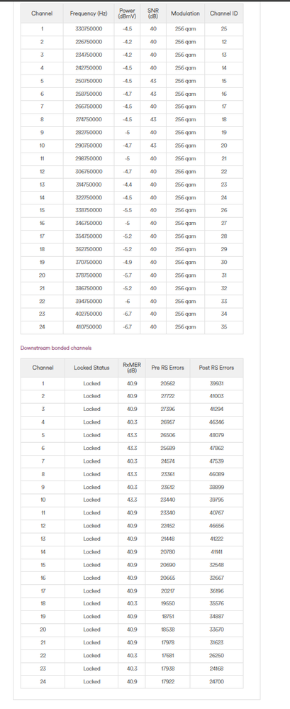

Have an issue with intermittent signal. Engineer has replaced damaged cables outside and now the Virgin hub inside. Still have issues with the signal dropping out. Happens with the Virgin hub in modem mode or not.

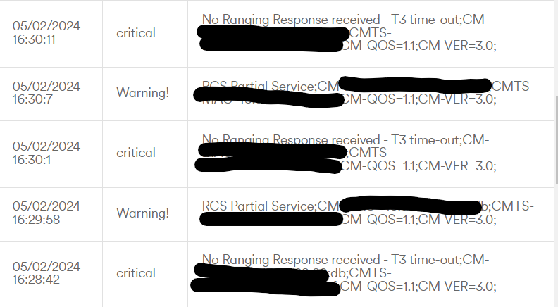

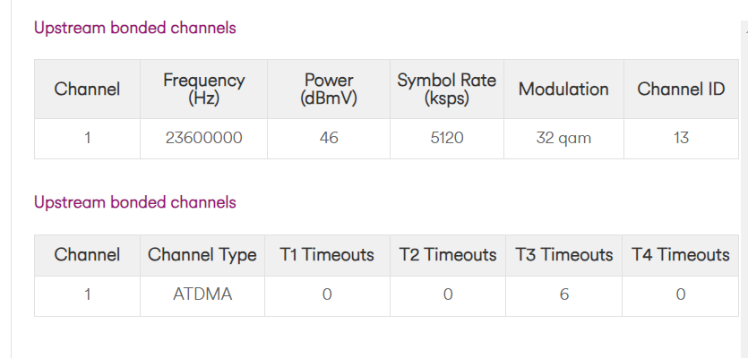

    If there really is only one upstream channel at 32qam... then there's your issue.  The down channel power levels are on the low side too anf there are post RS errors.  Strt from a clean sheet and do this...
    Switch the Hub off and unplug it from the mains supply for five minutes. Whilst it's off, do a quick check that all of your coax and ethernet cable connections are in nice and "finger" tight - at the Hub and wall box and also at any connectors etc. Ensure there are no “unterminated cable loose ends. Disconnect all the connections and reconnect to be sure. Also check that the internal wiring is ok with no kinking or chaffing. When its light, check that all looks good with the outside cabling and wall box (no “staples, etc.,) piercing the cables. Then switch the Hub back on and leave ~5 minutes When all done, check back in the settings and ensure that the RS error counts and T3 errors have all reset to 0. Then check every hour or so to see if they start reappearing - they shouldn't. If they do (particularly the postRS and T3 ones) you have a problem (noise) that only another Tech visit will sort.
    Also check the Upstream channels have reappeared and all QAM’s are at 64

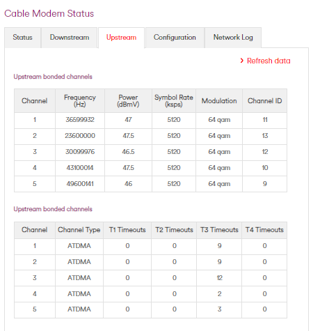

      Had one installed by an engineer, same issue
